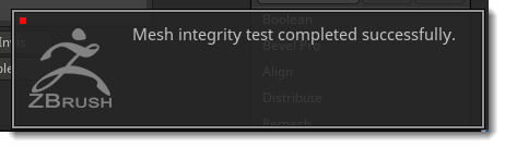

My loop does a “Fix Mesh” which throws up the following note:
Screen Shot 2023-03-09 at 12.36.09 PM
Is there any way to dismiss this automatically?
it just requires a click anywhere to make it go away, but I have to click each time!!
Click…
Click…
Click…
Click…
Click…
Click…
Click…
Click…
ect…
