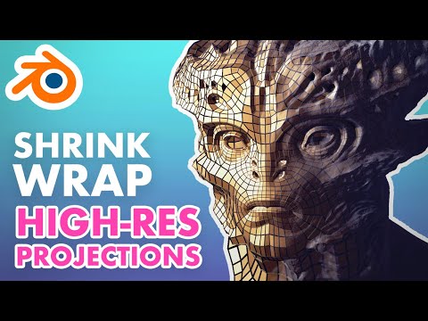

Situation:
High-Resolution mesh created with Dynamesh
→ Low-Poly mesh created with Zremesh
issue:
The zremeshed version deviates too much from the original high-res mesh.
I would like to “wrap” the low-res mesh closer to the high-res mesh original form and shape.
In Blender, there is a modifer called “ShrinkWrap”. It basically does this trick, you can see in the video below:
I know there is also a Plugin for Zbrush, called ZWrap.
However, is there any Zbrush default feature or option to get this job done?
Any ideas and thoughts or links to some video tutorials would help a lot!

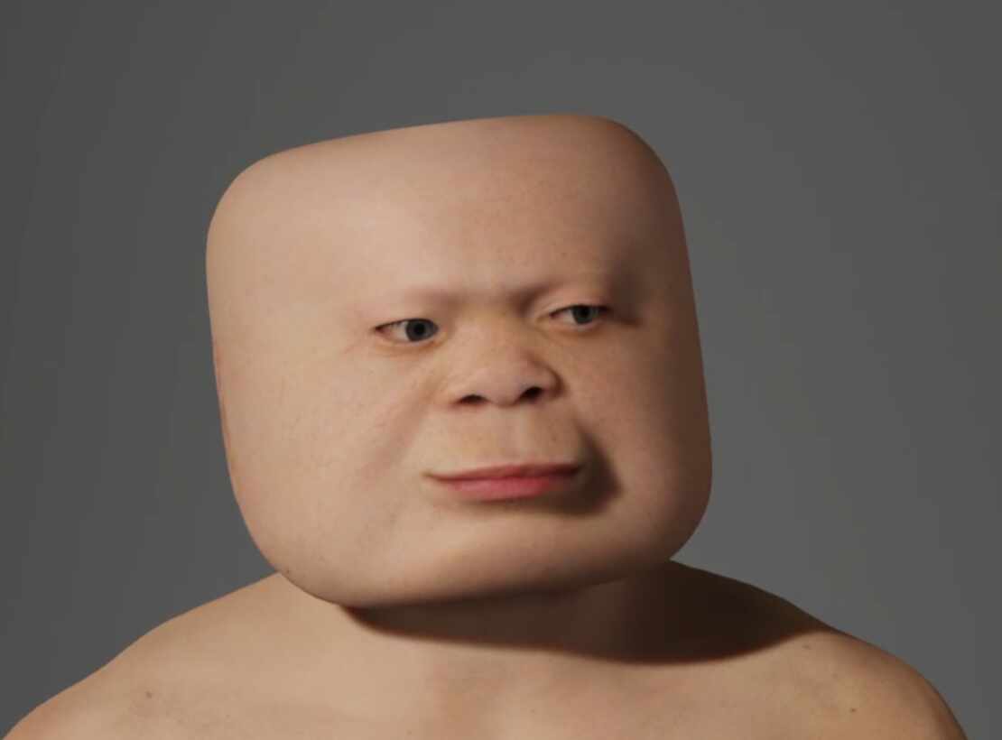

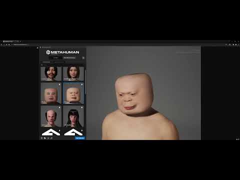

Well, this is not quite what I am looking for.
please see the short explanation video below, that should help to understand what I am trying to achieve with Zbrush Vanilla, and no additional plugins:
Any ideas, thoughts, etc. how I could do this with Zbrush default features.
