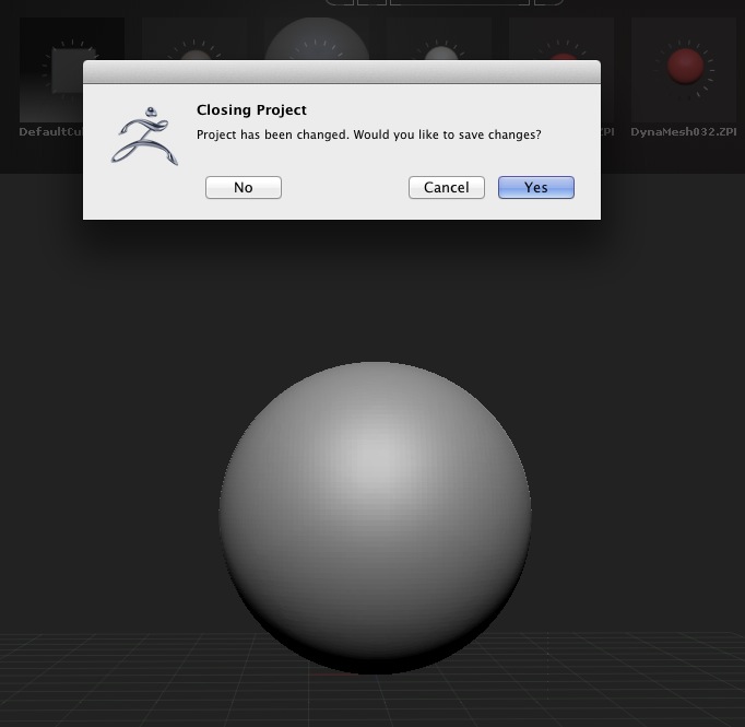

Hi,
I have a startup macro that loads a default Dynawax Zproject. I first initialized Zbrush → ‘New Macro’ → (Init again) → load my ZProject → Choose a MatCap → ‘End Macro’ → Save “StartupMacro.txt”.
Everytime when I startup ZB4r4 I get this dialog box (see attached jpg). Is there a way to disable this message on startup, or should I record my startup macro some other way? Also, I would like to turn of the Spotlight menu on startup. Is that possible?
Thanks!
/ Tennet
Can you post the whole macro so I can take a look (just attach the text file to the post)? It might need editing.
Provided you have the latest version of ZBrush 4R4 (P2) then you can turn off Lightbox showing at startup. Simply turn off Preferences>Lightbox>Open At Launch and then save the configuration (Shift+Ctrl+i).
Do you have ZB 4R4 P2?
Yes, I am using 4R4 P2, so Lightbox has now been disabled on startup. Thanks!
Attached is my StartupMacro.txt. Hope it is possible to get rid of the “save changes dialog” on startup also. Thanks again.
StartupMacro.TXT (302 Bytes)StartupMacro.TXT (302 Bytes)
Thanks. This seems to be an issue with the default zscript, not the macro. The default zscript is running twice for some reason. To stop it, open the ZBrush 4R4/ZScripts/DefaultZScript.txt file in a text editor and replace the contents with this code:

Thanks Marcus,
Your code did the trick. I just had to edit the line “[IPress,Macro:Macros:Misc:StartupTest]” with the name of my macro “StartupMacro”. Now it works, no more startup dialogs. Thanks again!
/ Frederik
