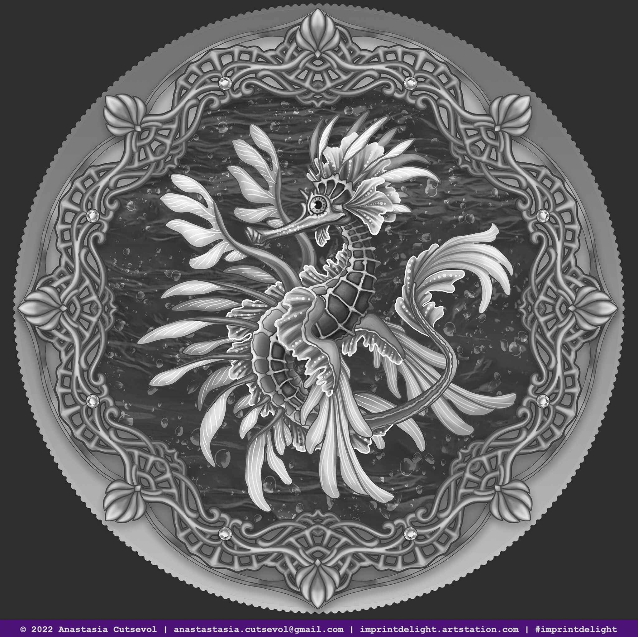

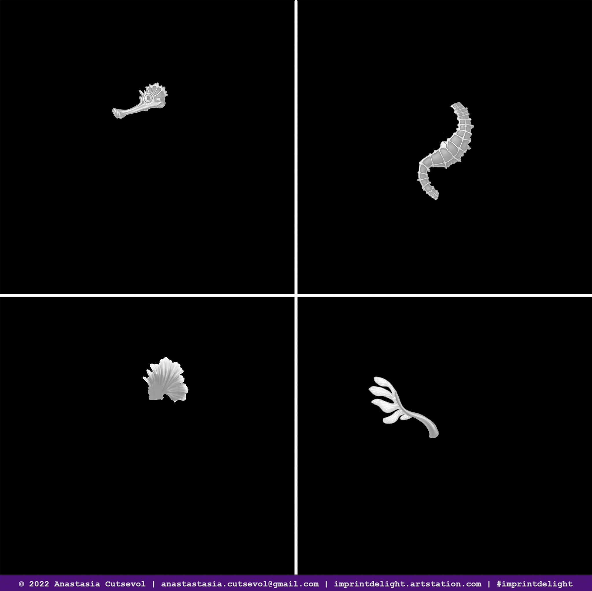

  1. Photoshop | Alphas export
Once the concept is approved, I prepare the alphas for the Make 3D process in ZBrush.
This is more than a good start. This allows me to have all the individual subtools in the right places with the main details from the 2D images.
It’s a simple process. I make each part on a black background in psd format. Light space will be convex space in 3d, dark space will be concave. Just remember that absolutely dark colors will turn into holes. So if ZBrush is done this way, I just use Levels in Photoshop to cut out the blacks.

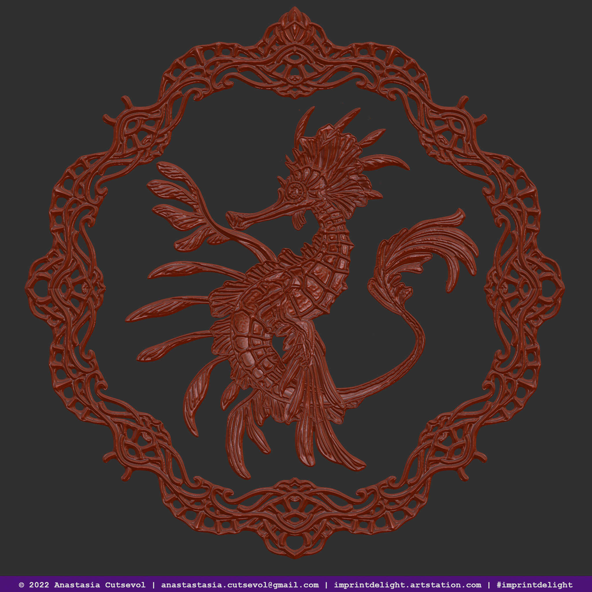

  1. ZBrush | Base Mesh
This step is about cleaning, positions and sizes.
My requirements: the diameter of the base of the coin is 39 mm, the relief is 0.5 mm inside and 0.5 mm outside. According to this and my concept, I set up each subtool.
I also enable Dynamesh mode and remove all artifacts.
If the detail is next to the viewer, then it has the maximum height of the relief, if further, then accordingly lower.
For relief height control, I use two 0.5mm deep boxes.

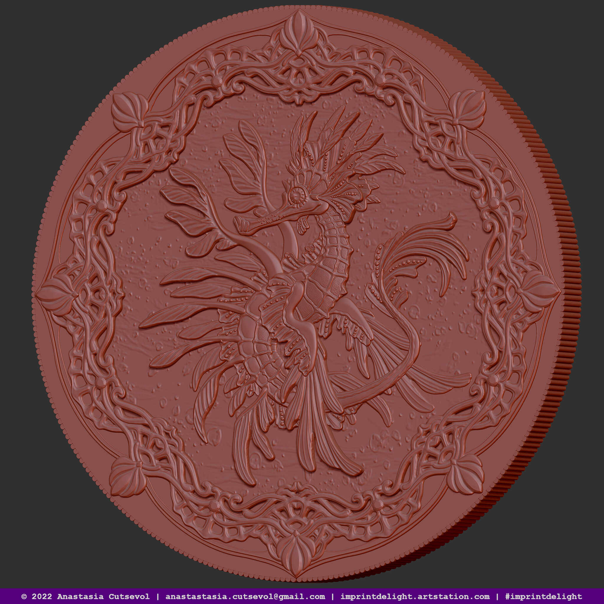

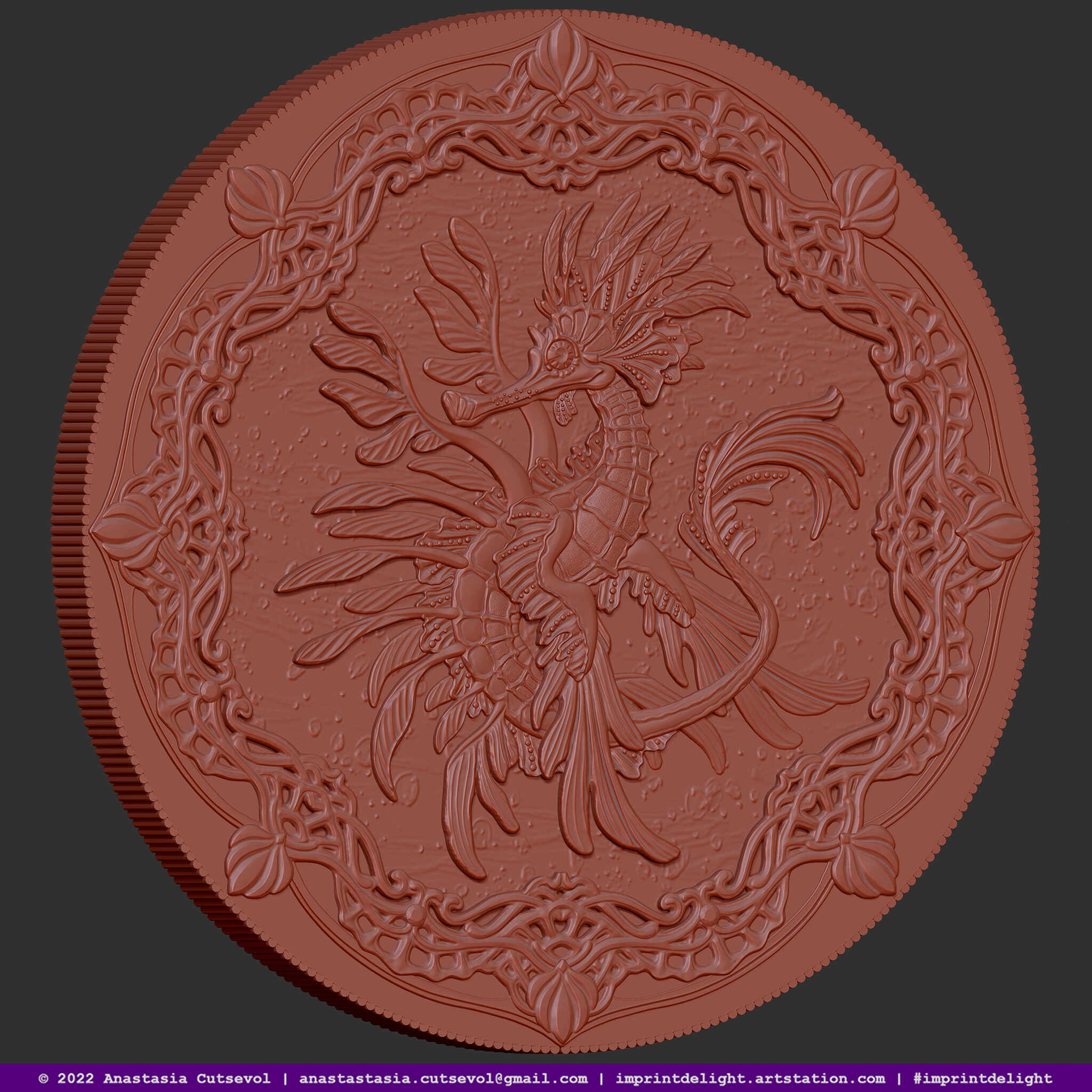

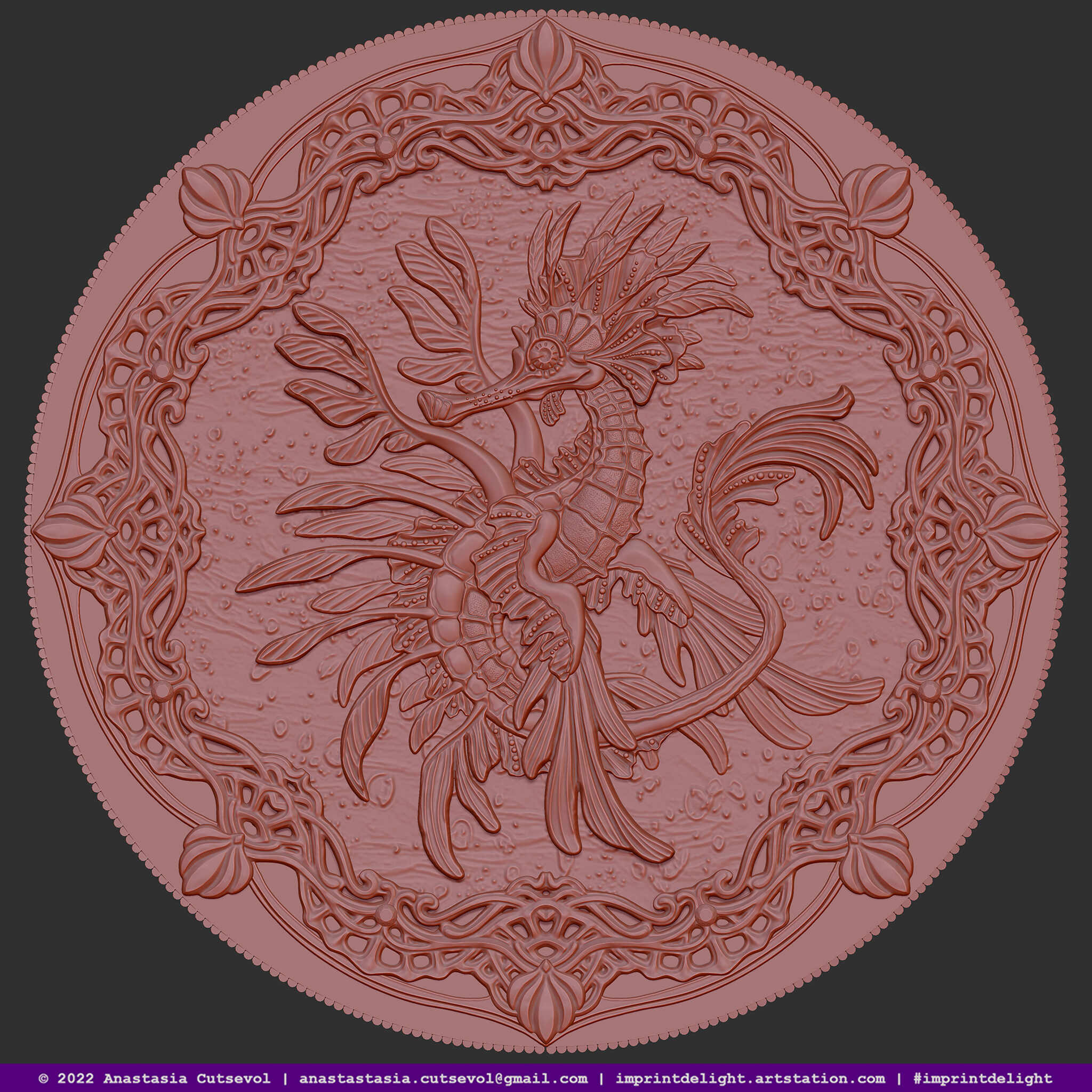

  1. ZBrush | Basic Sculpting
The sculpting itself. I use my favorite brushes to make the base meshes look like the reference image.
There are not many worlds; it’s years of practice.
Just a few moments
  • the key is using good material to see what happens, with a cavity function such as Red Clay
  • sculpting a bas-relief is almost like a full 3d model
  • since the detail is thin, I use the brushes in the Backface Mask mode
  • to make the relief more complete, I always remove the straight cut and chamfer the edges
    seadragon_6

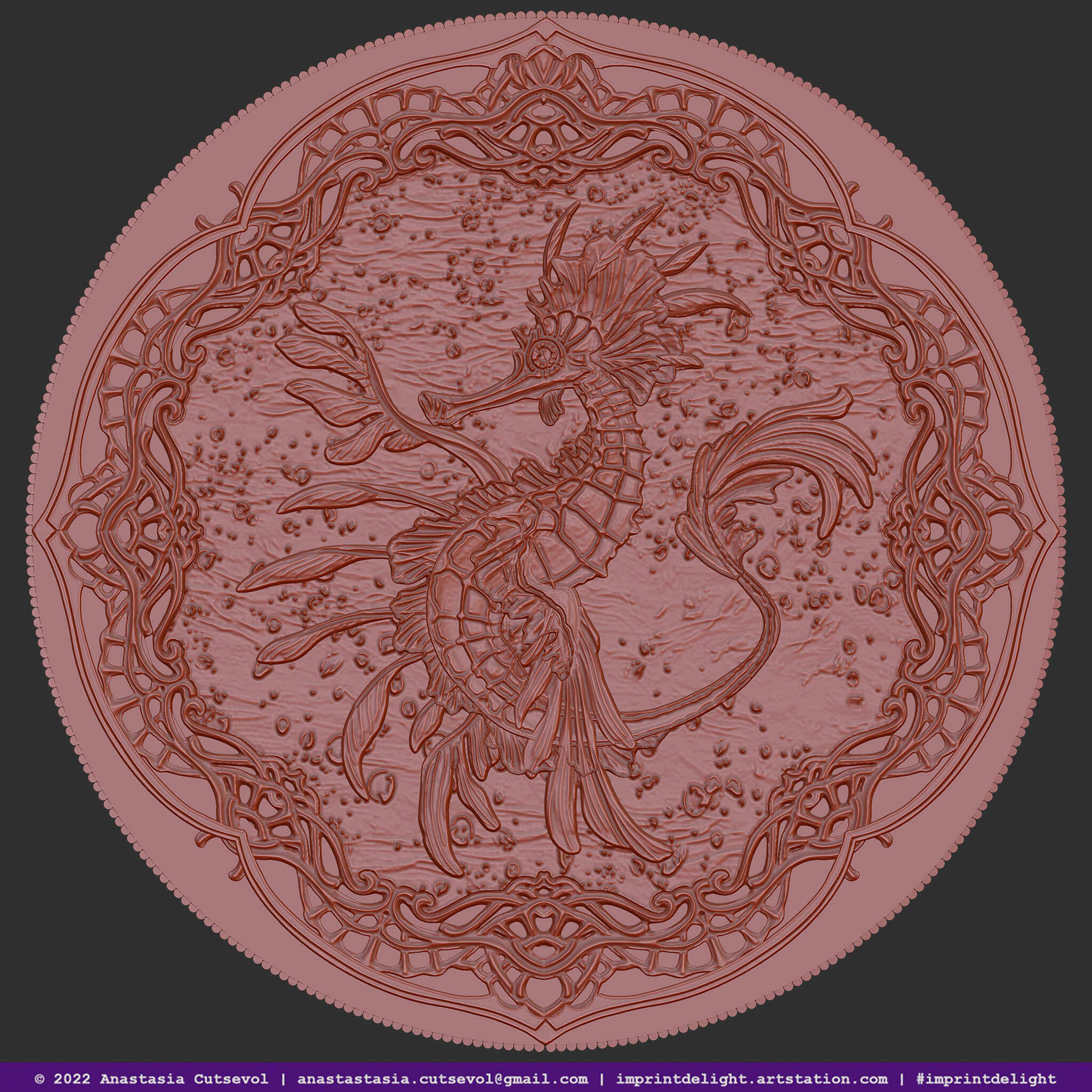

  1. ZBrush | Advanced Details
It’s kind of a challenge to find extra volume in a super cramped space. But as for me, after that the relief looks better. There are some tricks that I use
  • I don’t ignore the z-axis, even in this case where the depth is quite small. Even a slight tilt creates a filling of perspective. Note its back wings and wing arms.
  • Once again about round edges. This makes the relief more voluminous.
  • I also use strokes when I need to separate overlapping parts. Look, for example, at its head fins.
  • Some alpha texture is also a good idea to separate the parts. Rough and polished surfaces create contrast. I use this to highlight his central part of the body.
  • Contrast can be done between the levels of detail. This gave me the ability to combine many layers in a low base relief.
  • You know that the farther away an object is, the more blurry it appears. Theoretically, I can use this with the Smooth Brush, but in reality I prefer to just reduce the brush’s depth effect. Look at the difference between front and rear wings.
  • The bas-relief is the bas-relief. This is not a physically correct scene, so I allow myself to break the rules if I need to. If any part is important, I can bring it closer than it should be. For example, his full head has the same relief height as his full body.

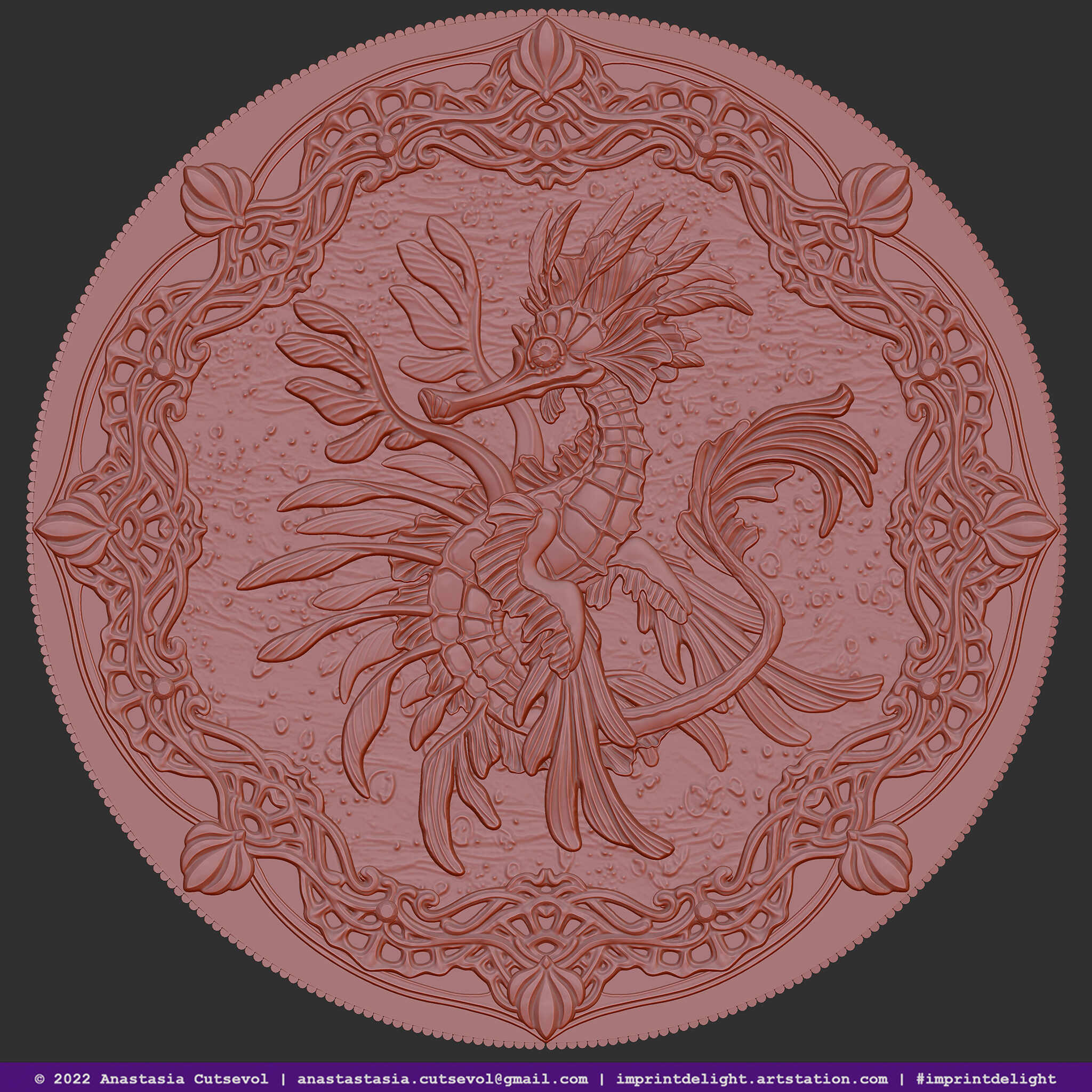

Well, here is the final sculpt

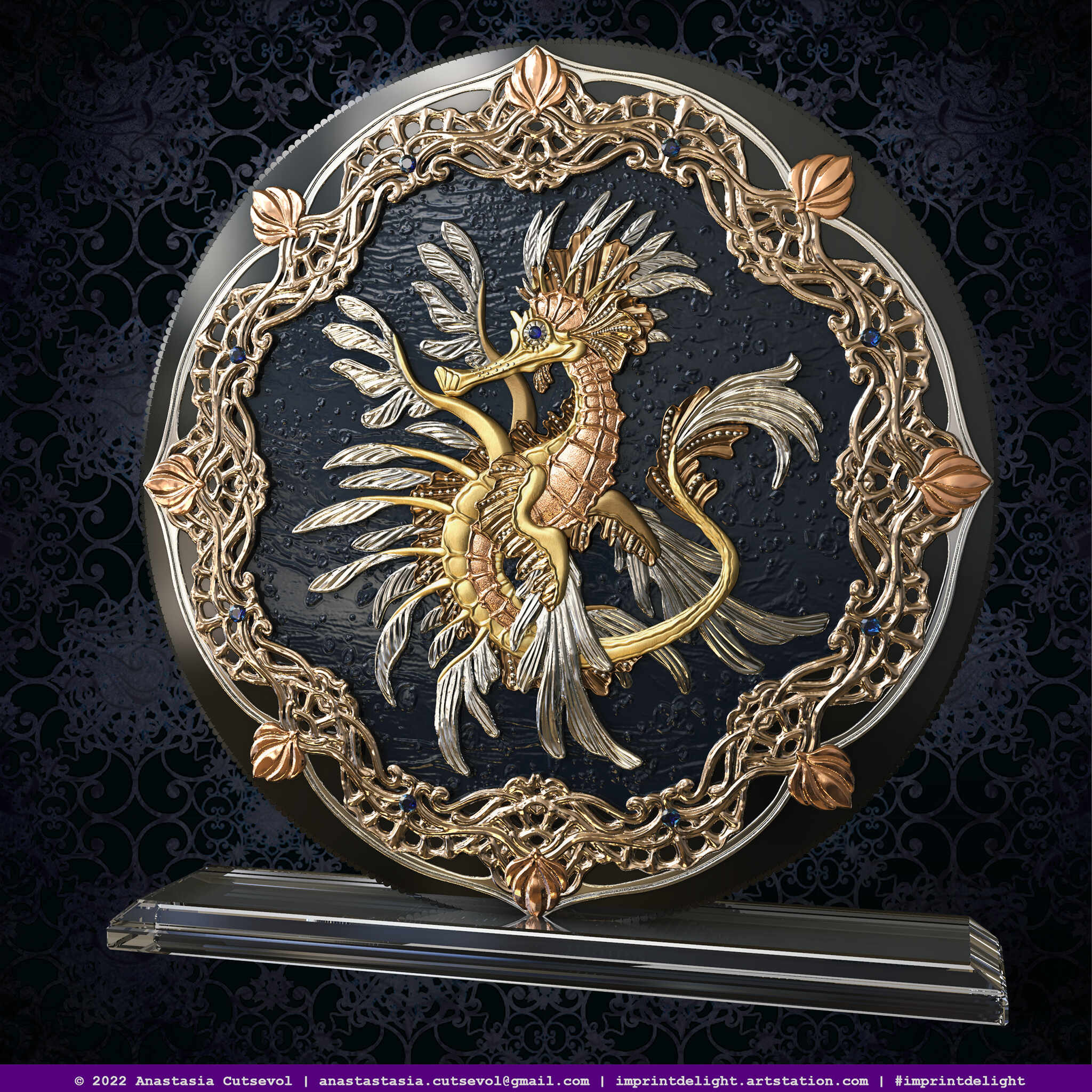

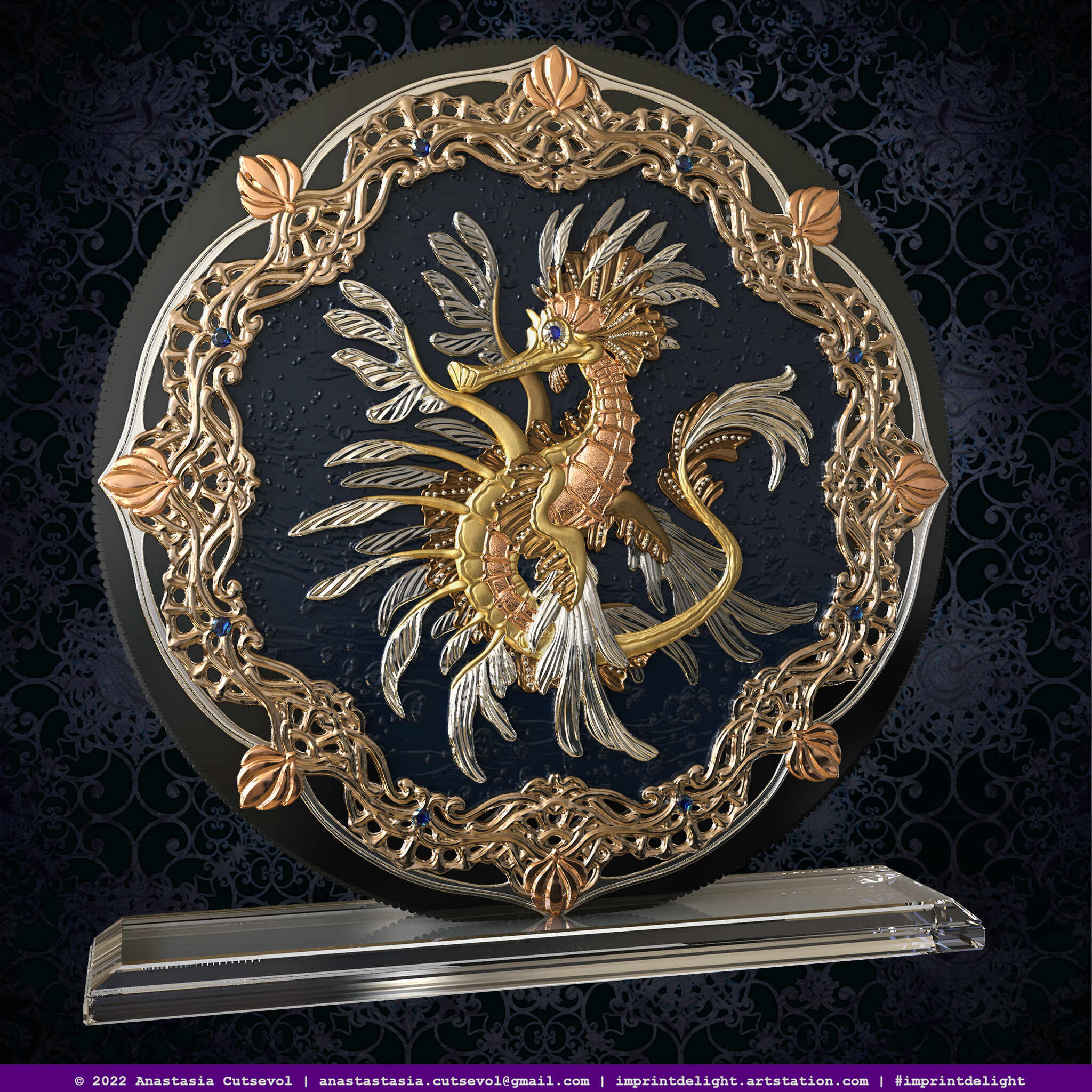

  1. Final and Keyshot Presentation
My final step involves checking the meshes with the Print Hub plugin. I checked the dimensions again and sent the final file to my client.
For my portfolio, I take several shots with Keyshot. I am using a bridge to send a model to an external render.
Since this is a coin, I use metallic materials. Keyshot is a great program, but sometimes after using it, I stopped counting on its realism. I use a preset and change it to my taste. Lightning is based on HDR images. Once I’m happy with the base image, I render it as layers and import it into Photoshop for post-processing.
And yes, this project started in Photoshop and ended in Photoshop.
Here are the final images.
seadragon1
seadragon3
seadragon4
