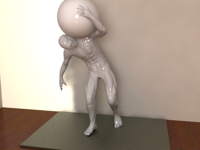

I have decided to play a bit with a technique that I’ve shown in my video and here’s what I came up with
and I have also started doing a tutorial on masking and layers that would demonstrate how I’ve done that statue

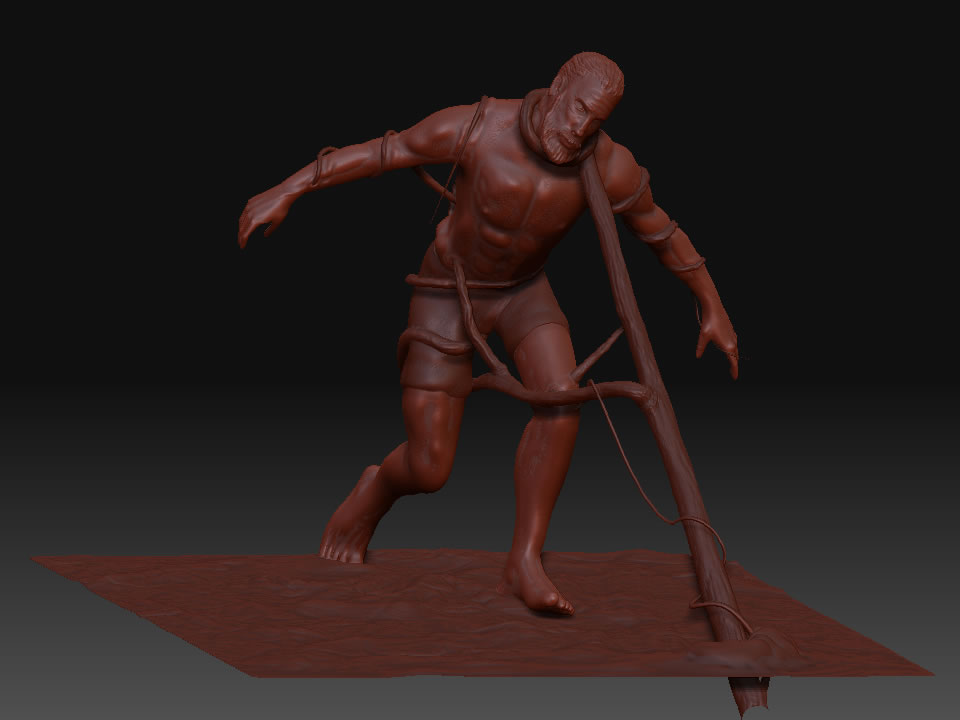

a good example would be one of my WIP images that I have attached to this reply, still working on it though so it is not finished yet :slight_smile:
