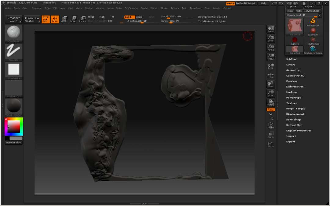

But is there anyway to get rid of the border?

Thanks, Jesse.Aitui! To make the border disappear you can select the second subtool (the transparent plane hiding the one you’re sculpting) and increase the Deformation slider for Size (Tool>Deformation>Size).

Pretty neat. I just sculpt my models and I don’t know much about document/materials. How did you make the second subtool transparent?

bLawless – Hi! Transparency in ZBrush requires multiple layers and turning ‘flatten’ off in the render settings. Then you can use the transparency property of materials to make them transparent to objects on other layers. The second tool is just filled with a transparent material.
Holding down ‘ctrl’ when hovering over the transparency modifier of the material will probably show more detailed info.
I think you mean the ‘opacity modifier’, because I can see no ‘transparency modifier’ in the material palette, modifiers.
In any case, I am so unfamilier with materials that when I tried to do as you say, it is not working (first I gave a subtool a new layer, then in the materials, modifiers, opacity, I slid the opacity modifier slider all the way to the left).
-Brandon
Not all materials have a Transparency modifier–you’ll have to pick something like the BasicMaterial or copy/paste shaders into materials with multiple channels.
Also, by ‘multiple layers’ I meant document layers (‘Layers’ menu), not subtool layers. You have to create at least two, and ‘Flatten’ in the ‘Render’ menu must be turned off.
Do this as an example to see how:
Your second stroke (on the second document layer) should become slightly transparent.
