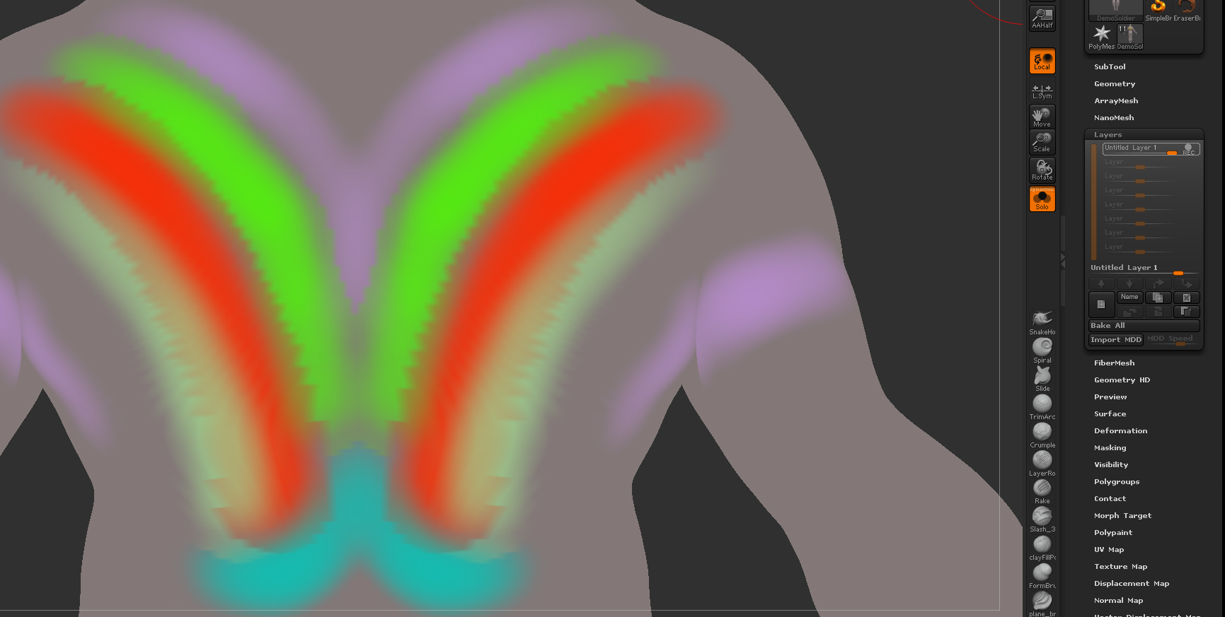

i just wanted to ask you about this issue that i have .
For example i have a grey model and i create a layer with record turned on , i start to paint just a simple lines with different colors but the borders of the lines is sharp and toothed. If i just paint on the model without layers the borders are fade in and smooth … I think this is some layer bug or something ?
Thanks !
I’m afraid I don’t know why this is happening. I tried to reproduce it but couldn’t - but polypainting on layers definitely has some problems (plenty of people have reported issues). So yes, it looks like a bug.
