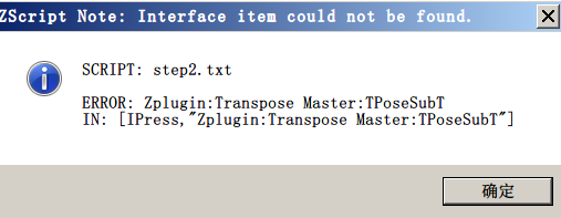

And I also found, I can’t locate that plugin button “Zplugin:Transpose Master:TPose>SubT”(or TPose>SubTool) in IPress or ButtonPress, I got only error if I perform these command. I don’t know why.
yes you’re right, especially with the Tpose function that can’t to work.
The path of the button you are looking for, if you do a CTRL and the cursor hover the plugin button you can get the path of the it so the “zplugin:Transpose Master:TPoseSubT” in your case.
Yes, I have tried many formats of this path like “Zplugin:Transpose Master:TPoseSubT” or “Zplugin:Transpose Master:TPose>SubT”, but just get an error as following. Totally confused.
Hi heroineism,
Normally doing as f​:relaxed:celess says and holding Ctrl to see the button path will give you the right path but Transpose Master uses a trick to get the arrow in TPose>SubT. ZBrush displays the pipe character ‘|’ as an arrow on the button (but doesn’t display it at all in the button path shown with Ctrl, which is unfortunate). Anyway, the correct path is:
“ZPlugin:Transpose Master:TPose|SubT”
HTH,
Thanks marcus, that’s really tricky…
