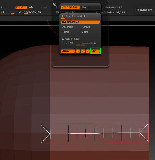

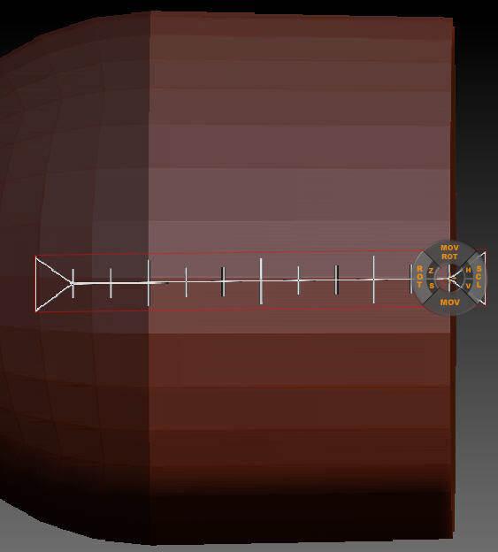

Hey Kurdadk and Hybrd75,
I had a similar need for some type of measuring tool and my work around was to create an alpha which would then be made into a Stencil and scaled appropriately with the Coin controller. I pressed the Stencil/ Elv button to make visibility a little easier. The good thing about using stencil’s with the Transpose actionline, is they don’t affect each other, which makes using stencils ideal as a visual aid.
good luck,
joe
That’s an excellent solution. :+1:
…You be some clever folk. :smiley:
good solution!
This is the one I use and offers more than stencil method :slight_smile: I like your method thou. I will give it a try
