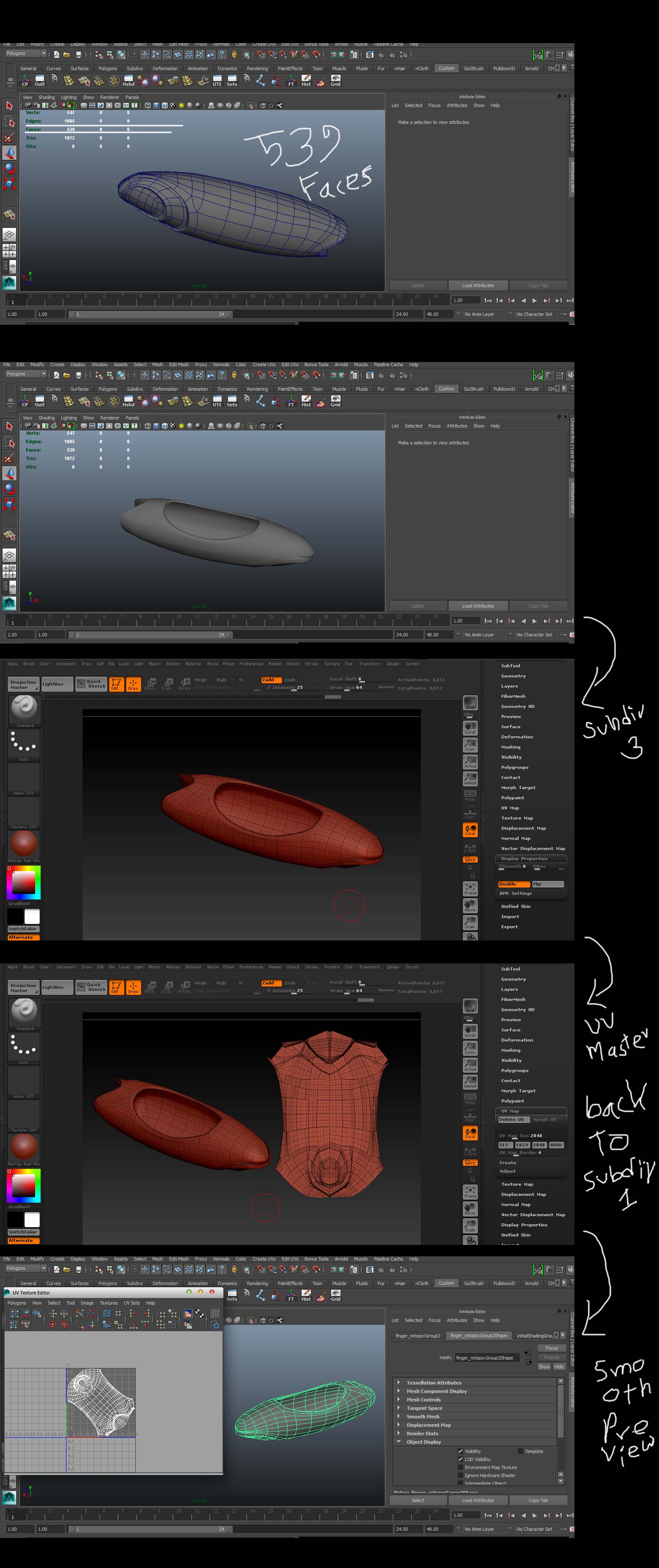

How well do you think that zremesher is for unwrapping stuff for hard surface? Could I see what it looks like after you did a bit of a clean up in maya :slight_smile: I use maya also
Hello, Meathelix. Sorry for late reply.
Here is the result:
Cleaning up the object in maya makes 539 polygons. Then I have gone to Zbrush exporting this cleaned obj. Used Zbrush UV master. As its an organiic topo, so its quite easy to decide the flow for UV master. it Took 2seconds. BTW I subdivided it 2 times to see the flow is right in subd 3. But It is not must. Then back to subdiv 1 in zbrush and export it back to maya and see the UV editor for the fresh piece. I have used Subdiv 3 preview in maya.
