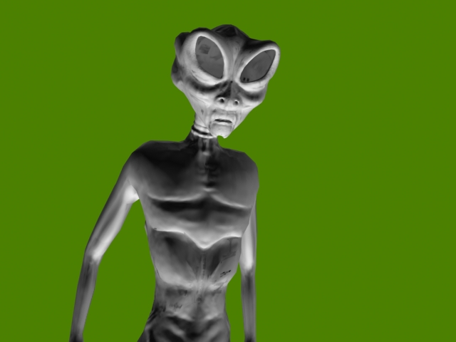

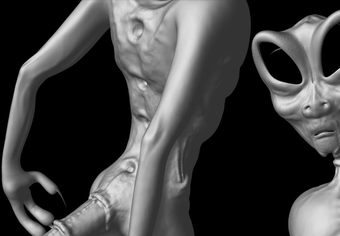

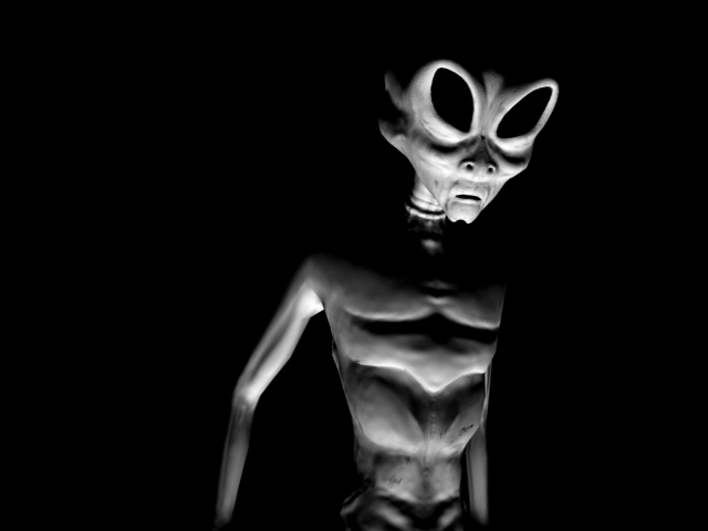

After exploring the forums only i got to know about the problems i made.I was quite happy as i found the alternate solution of unwrapping as GUV tiling in z-brush(is it?).But triangles i don’t know.The following is Zbrush Render:
If the problem is because of triangles, then is there any solution to it.

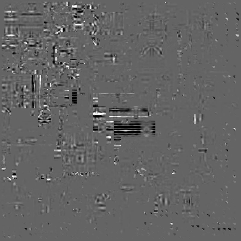

If you are getting problems with triangle puka’s in your mesh, export out at sub d level 2, as this automaticly makes your entire mesh quads.
as far as your offset asnd gain, offset must be -*2 the gain, so if your gain is 2.2, then your offset must be -1.1,
and with the normal not giving you the right amount of detail, just up the bump depth?.
Hope this helps.

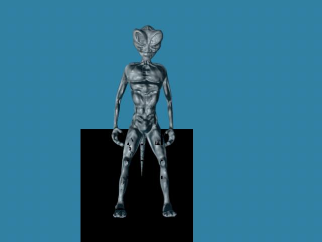

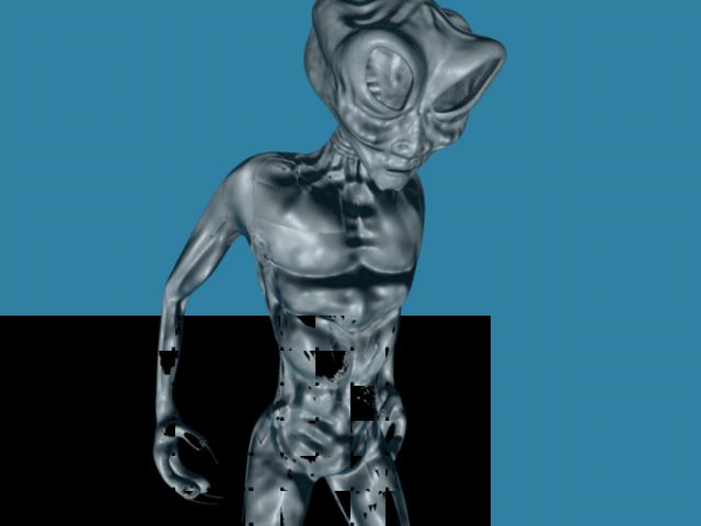

im having a problem with my render using MR. i brought my mesh into maya as an OBJ and set up all the settings the way they should be, in the app. editor and the alpha gain and what not. i saw that i had some artifacts in the render so i smoothed the mesh to straighten that problem out, when i did this MR would not render. in the output window i get an “error: invalid topology” message. after this i tried importing a sub level higher from z brush, sub level 2. and it will not render either, with the same message. why will it render with the sub division level 1 obj but nothing else?? very strange, ive never ran into this problem before…

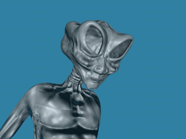

     I tried the one you suggested yesterday about increasing the subDiv to 1 and then exported.Still the displacement is not coming properly, only the normal mapping works.I followed one video tutorial from zbrush central about uvlayout,normal mapping,cavity and displacement mapping.I am now usng both cavity and displacement.When i got the output of 32 bit displacement map and put on my model and rendered in maya, a error comes "Invalid Toplogy" same as abone114.
    It comes only when i use 32 bit displacement map, incase of 16 bit it renders and looks like bulging out.Just the normal map works quite well but it has a low-poly look.

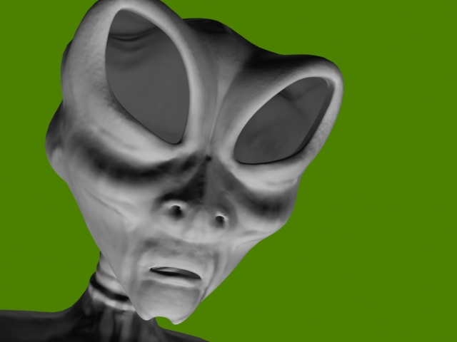

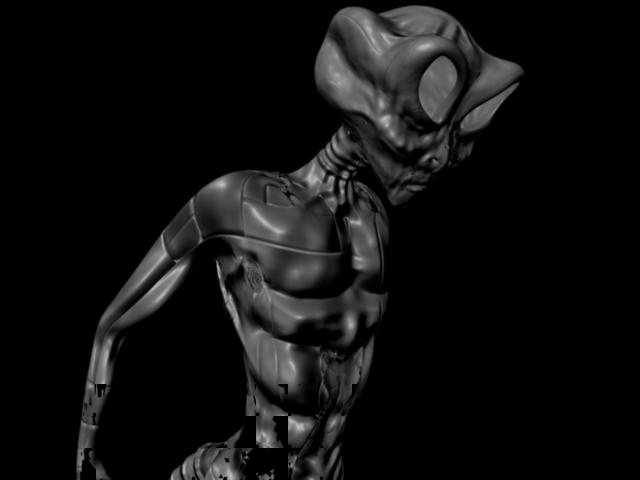

I tried normal mapping, it works but i was not getting the detail and yes I am Zmapper for normal mapping, and how to use cavity maps?It is giving black spots.You can see this again:
