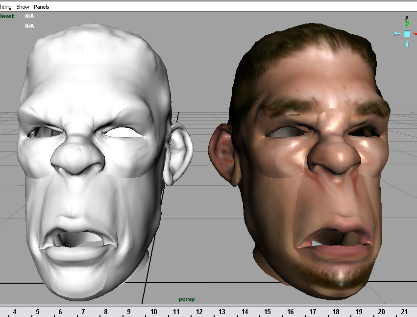

about the holes well they dont show anymore, but i got the seams showing up as the image i post below. MR wont render my disp map. ive follow a tutorial in this post and i got a render after 15 minutes of a small region that was all the vertices going crazy and me going crazy too.
In zbrush all seems so beautifully nice :evil: :cry:
