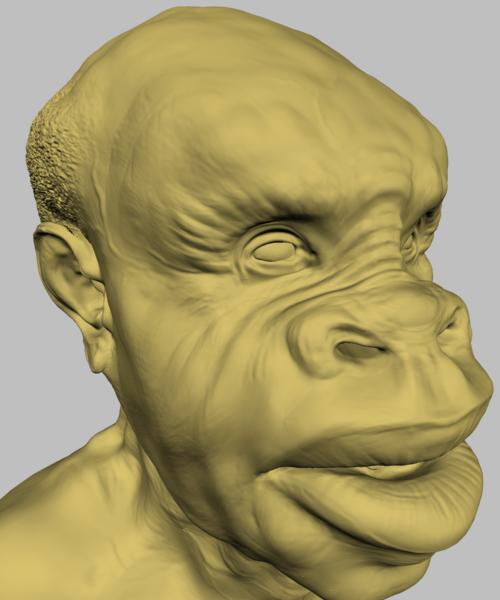

After a good few hours playing around with Pixolator’s demo file, it suddenly struck me why it seemed to be so difficult to get a good result out of C4D.
The displacement file supplied is set to have 50% grey as a base point, while white is ‘high’ and black is ‘low’; C4D’s displacement works on black as the base point, and the range–going up through grey to white–indicates higher points. So no amount of messing with constrast, gamma, etc. will actually give the correct results.
To test this, I did the following:
I then used the displacement map filter, with constrast, gamma, etc. all at the default settings, but using the clipping values to only use the values of 50% to 100% (mid grey to white). Displacement set to 8.34m (taken from the source thread as the displacement-gain of the map), and at 100% strength, this gave me a render with the ‘high’ displacement areas.
Same again, but clipping the values from 0% to 50% (black to mid grey), gave me the ‘low’ displacement areas.
Then, by combining the two (fairly roughly, I admit) we get the combined, ‘correct’ displacement.
This is, IMHO, a much better match to the intended look.
Until C4D does displacement from a 50% base, displacing up and down in one go, or we get a map out of ZBrush that is from a black basepoint, C4D will never be as accurate as some of the other renderers.

Turns out you can get a fairly good result with mixing textures and creating a +ve and -ve map by inverting and clipping the supplied map…
Rather than explain what I’ve done, I’ve put the file up here. (If anyone else wants to host this, feel free.)
Thanks for the files Creed! I assume you did this in Photoshop or similar app? I’ll have a go at this myself but I’m not sure how to go about it so if my experiments don’t work out I may get back to you!
- Baz
Yeah, I used Photoshop to invert the second version of the displacement file (for the low areas), and re-save both as 16-bit PNGs, which seemed to work better in C4D. Other than the re-save and invert, I did nothing else to the files at all. The render above is straight out of Cinema, with no post-processing at all.

Here’s a comparison of the same model with 4 subdivisions, using the displacement map as a bump map for higher frequency detail, to the model with 5 subdivisions and no bump map.
http://homepage.mac.com/creed_nmd/.Pictures/CGTALK/subdivisons_and_bump
