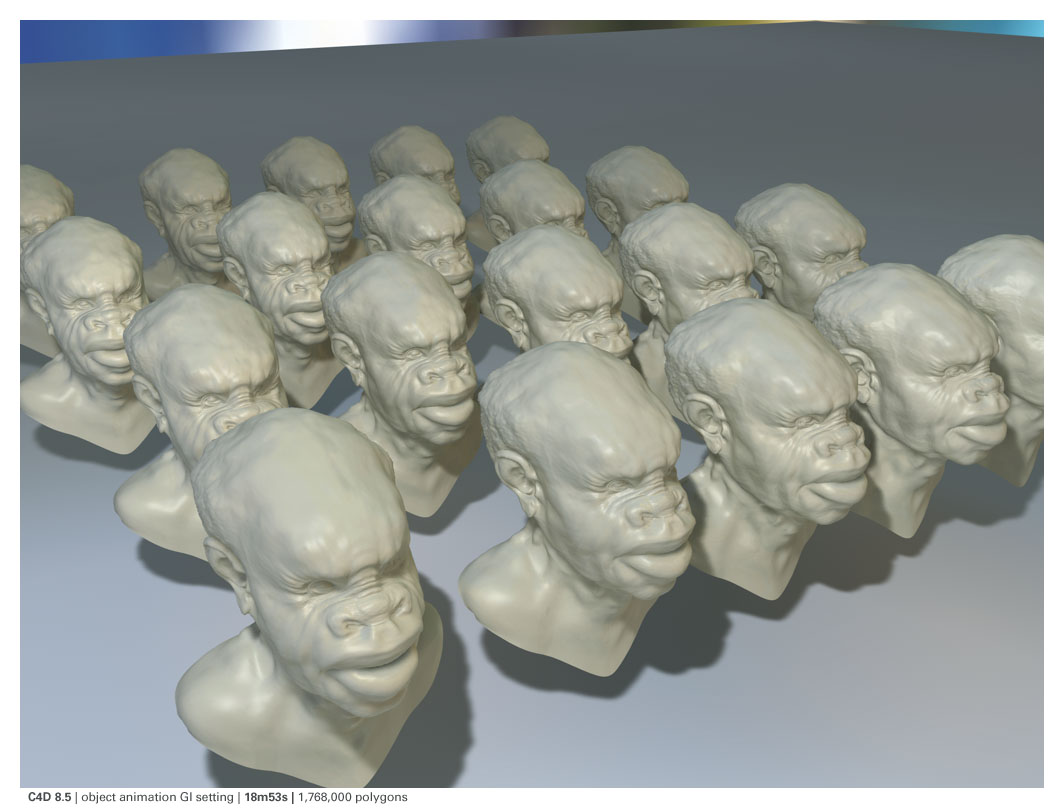

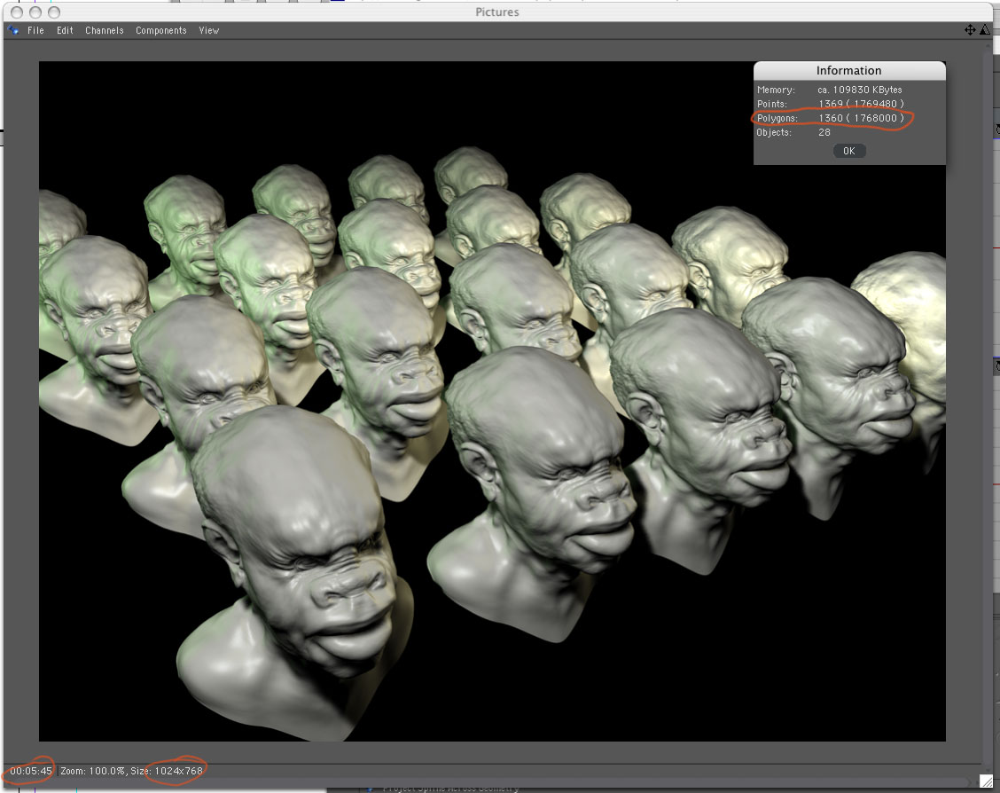

having some more fun, this time with instancing.
woo hoo!
C4D roxx!
rendered on a 1ghz PowerBook with 768mb RAM.
I’ll wait to do a GI test on my Dual 2.8 XEON at home.
woo hoo!
C4D roxx!

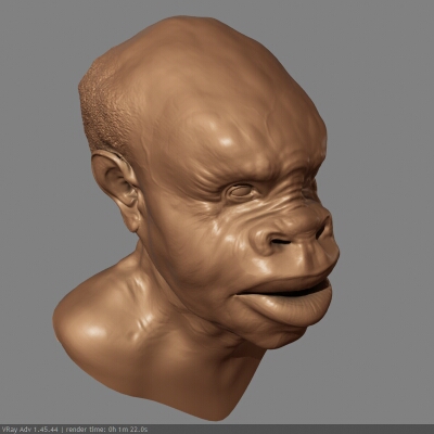

A question for VRay users:
Every time I render, I get those tiny black dots (I think they are small holes). They seem to be visible on the UV seams but why doesn’t anyone else have them. Well this thread is so huge I might have missed it if this has already been answered. Heavy antialiasing hides most of them, but that takes so much longer to render. Any ideas?
are you used 2d or 3d mapping?
the 3d mapping is little bit slower but the mapping more precise.
Here is an image rendered with a more recent version of VRay; 3d displacement method, two raytraced lights and GI:
