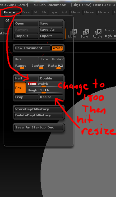

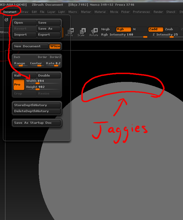

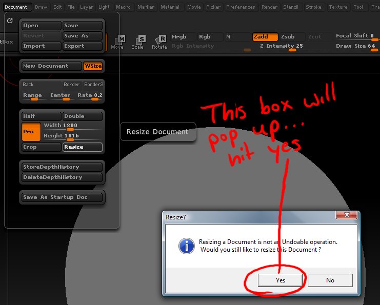

Hey community. I follow the main forum daily, if not hourly and i’ve noticed that alot, if not most people who post stills of their W.I.P.'s and even finished works are still unaware of how to render or screen grab their doc without fixing the antialias first. Its actually really easy to remedy and you can actually model in real time with perfect antialiased edges, so i put together this quick tut for people who don’t know. hope it helps.
Notice the edges and the default doc size…

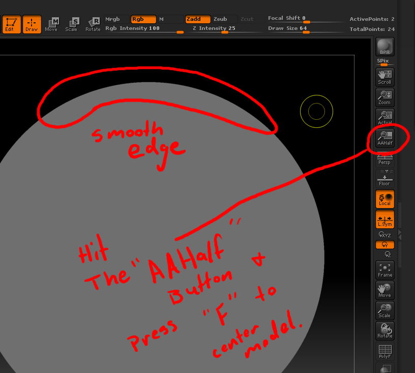

Its essentially doubling the size of your document… and “AAHalf” is filling the canvas with the larger doc. You may get a little lag when modelling but it has never been enough to bother me… i prefer the cleaner view… but when rendering or sceengrabbing it will save you alot of hassle in ps. So, i hope this helps some people… and cheers!

in the tut, where i change the doc size… you could just hit “double” insted… it does the same thing. but there will be moments where youll want to put in your own parameters. so its good to know how to do that.

Hi mjolnir i have made a similiar post here http://www.zbrushcentral.com/showthread.php?t=78713 and try to spread the word here those jaggies bug me too ! to add as in my post if you have a really high poly model that is hard to position at that size document doubled you can position your model then mark it then double document size select model click on marker in resized document for same scale and position one click then aahalf and export

“The new canvas will show your model ultra jagged…” ← That’s where i got to, and thought, this cant be right :slight_smile:
“Just hit “ctrl N” to clear the canvas of subtools then redraw your model on the canvas. Hit “T” to drop it.” <- thanks for filling out the missing piece of the puzzle.

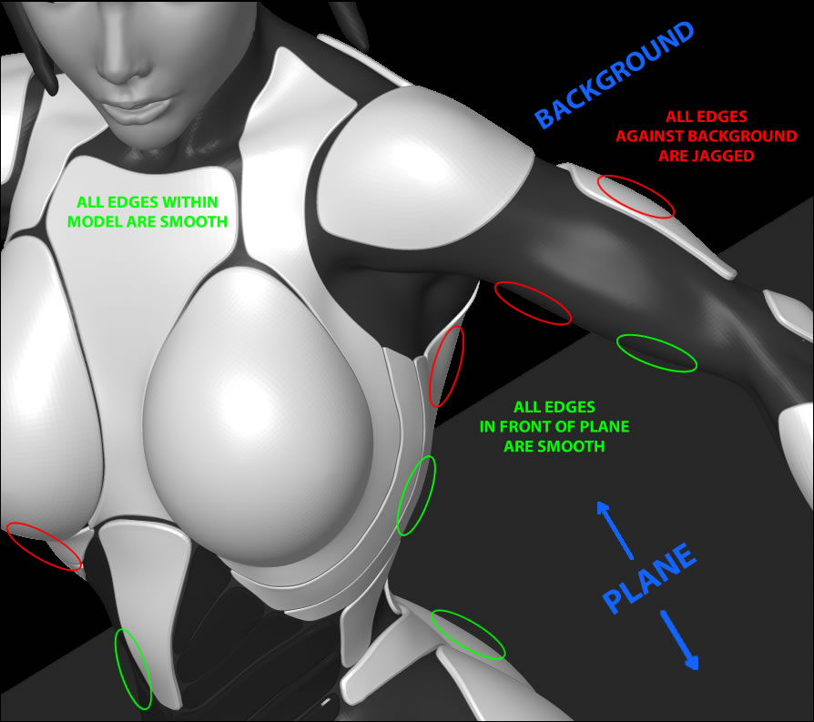

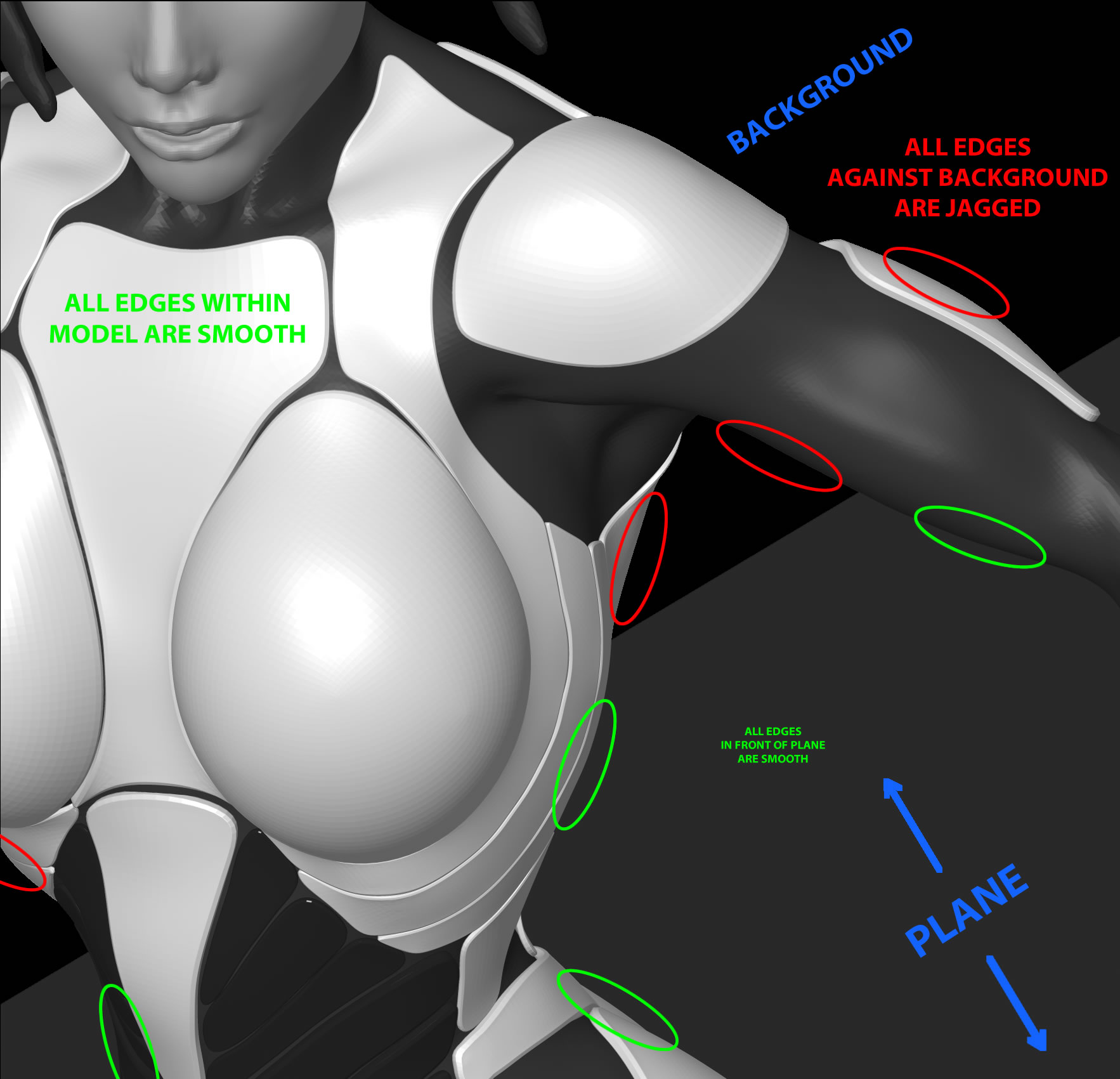

I realize this is an old thread, but I’ve recently been trying to render a sculpt and get some decent output and came across it.
I’ve been upping my document size, just as explained above, but what I find most unusual is that the real problem with anti-aliasing resides in the edges of the model that are against the Zbrush background.
If an object’s edge is in front of another object, then the edges are anti-aliased, but if there are no other objects behind the edge, the edge is aliased and jagged. I’m including samples of renders at the standard resolution and even a much higher resolution and both show this. I’ve been placing a plane behind my models to avoid the aliased edges, but I would prefer to simply have the gradient background without the plane.
