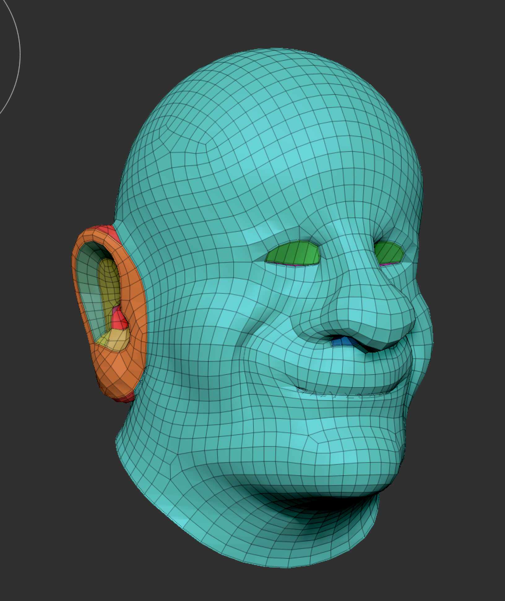

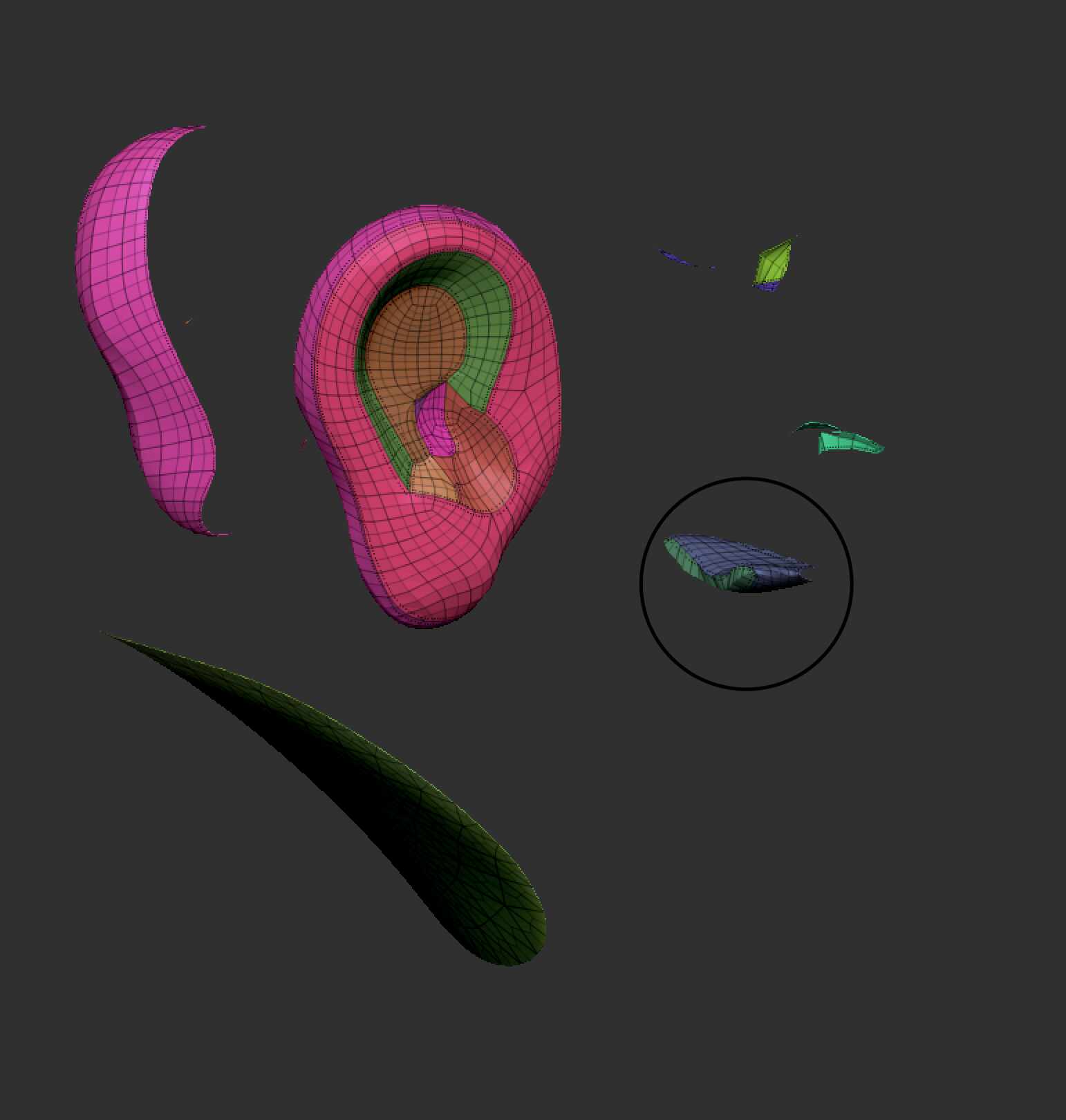

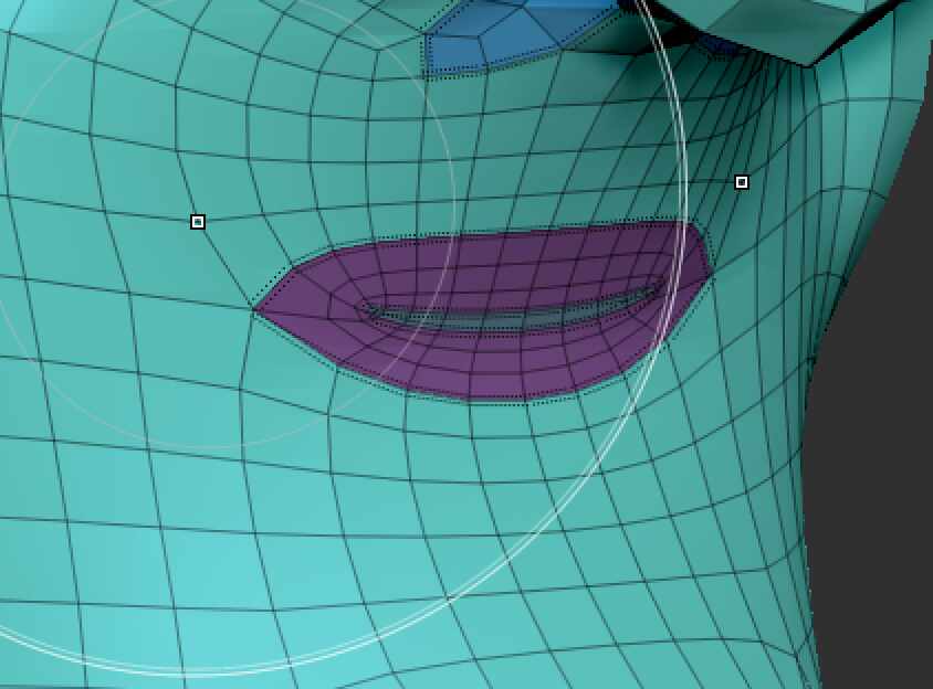

Sorry to be so vague. Ive attached some images. So the heads all watertight. Ive shown in the interior mouth bag (purple polygroups) by hiding the head polygroup. Ive also attached an image of the mouth bag all smoothed down to show how its welded to the head.

mouthBagGroups Screenshot 2022-08-08 at 22.28.35 Screenshot 2022-08-08 at 22.39.32 smoothed mouthbag

Ok, your problem here is that your lips are intersecting. Intersected geometry is fused by the process, and everything inside will be eliminated. You’ll need to open up the lips to a neutral position so they are slightly parted, and then pose them after the geometry is stable, just like working with a T-Pose. The “Move Topological” brush can be useful for moving one lip while only minimally affecting the other.
The only reason to have an articulated mouth cavity is if you wish to be able to pose the character with open mouth poses. So the problem in this case is that you did not create the character in a sufficiently neutral position for that purpose like a T-Pose to complete your modeling before posing.
