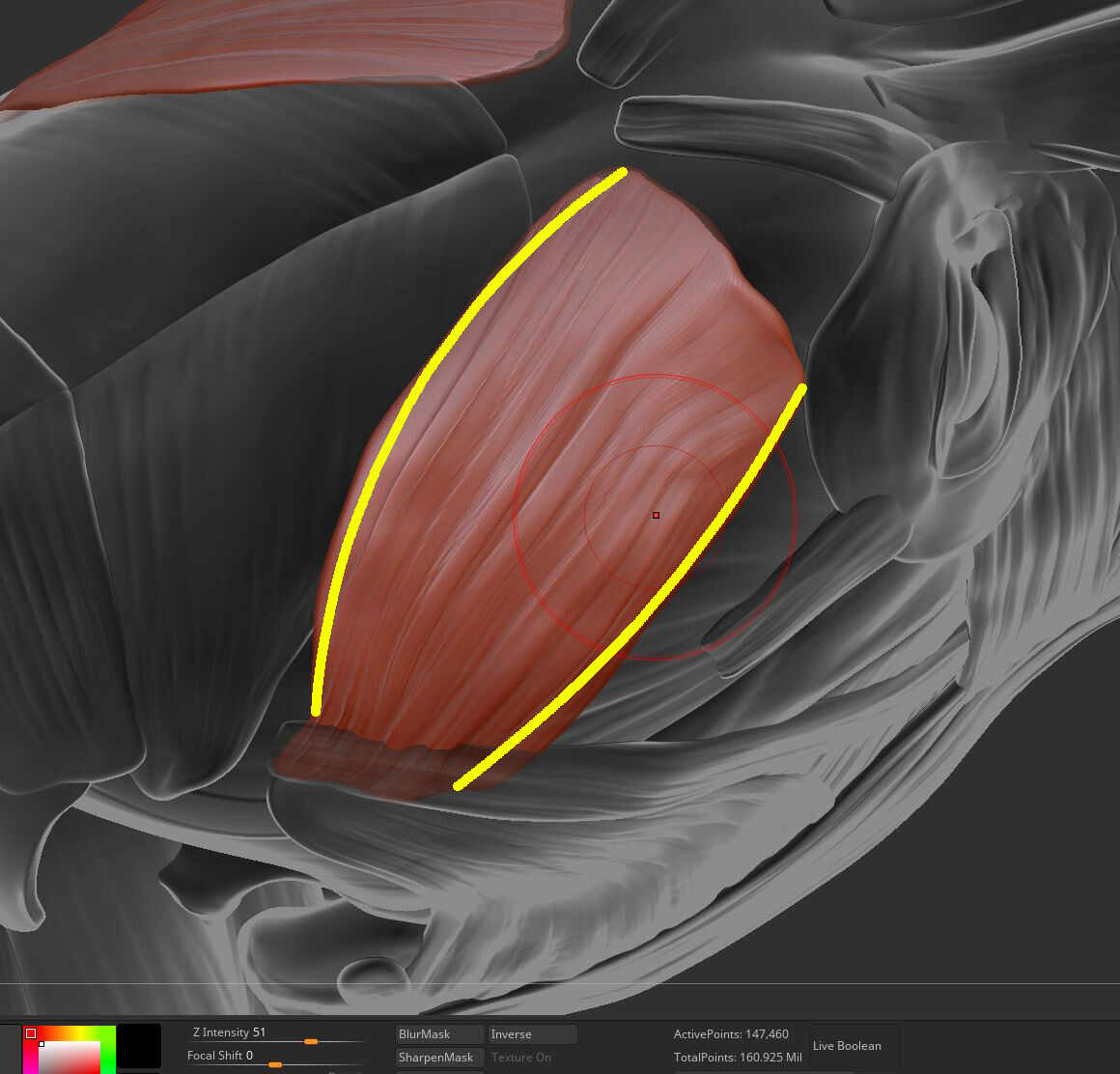

I have been pushing and pulling a thin piece of geometry to achieve the correct overall flow. This has left me with an uneven edge to the geometry however.
I’d like to relax / smooth / tighten this edge somehow. I’ve attached two images - the first of how the edge looks (wavy)
relax

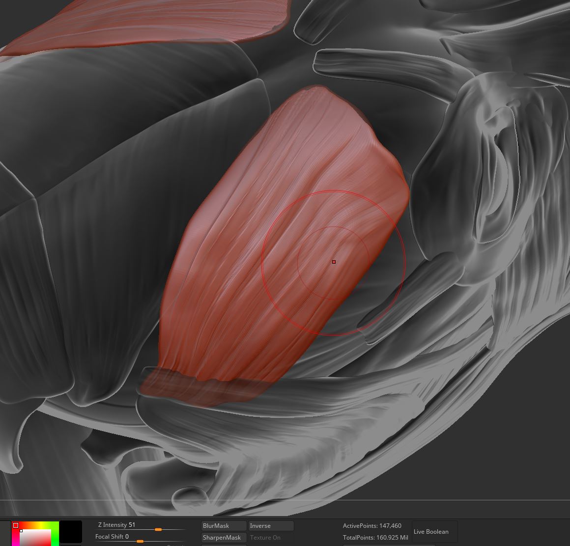

the second of how I would like the flow of the mesh edge to be (a taught smooth curve / line)
smooth

Hi @arumiat,
I think in this specific situation I would do the following.
  1. Hold down Shift+ Ctrl, then click on the Brush selector button. This will allow you to select the active selection brush from a list of only those brushes.
  2. Select the "Clip Curve" brush. This will allow you to draw out exactly the curve you’d like to flatten the mesh along in screen space when you hold down Shift+ Ctrl. You can add multiple “bend points” to the curve as you draw it out so you can get exactly the contour you’d like. Tapping Alt while you draw the curve will insert a soft bend at that point. Double tapping Alt will insert a hard bend point.
  3. This will flatten the mesh to machine perfection along that curve. However it will also compress the geometry in that area, making it difficult to work with for other operations. Resurface the mesh with Dynamesh or a ZRemsher+Projection process to redistribute the topology. Then you can manually smooth that edge as desired to make it softer and more organic looking.
Good luck! :slight_smile:
