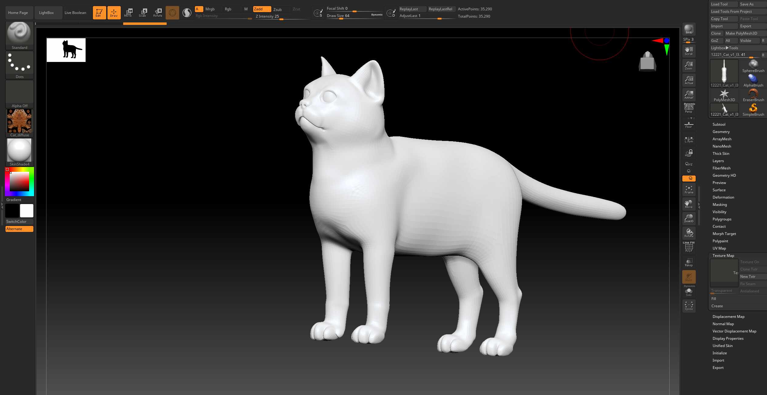

But object is still not textured.:

I think i have found the “Bug”.
If i open ZBrush and execute Script. Then the texture is not apply to model.
But if i execute the same script second time, then the texture if apply.
Is this a ZBrush bug? Here the Video: Video
Do you have a idea? This command works only if i execute script twice. If i open zbrush and execute script … it not works
