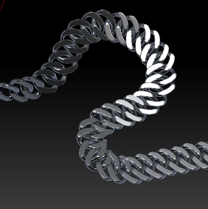

Although I can imagine uses for a script of the sort you want, in your particular example of a curb chain I’m not sure it wouldn’t be quicker to model by hand. I attach a quick example.
Ok here’s what I came up with.
I made a modified ring, rotated half of it 50 degrees on the x axis, rotated the whole thing -25 degrees on the x axis, flattened parts of it with the deformation sub palette, and then made an insert mesh curve brush with it. Piece of cake. You’re right- It’s very quick and easy this way. I just can’t really get crazy sculpting the link with compound symmetry at this stage as I described… Oh well. I’ll keep playing with it and I suppose it’ll serve my purposes for now.
Again, thanks a lot for your help.

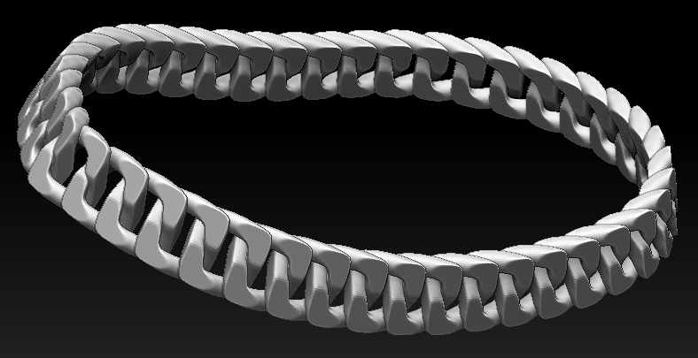

I never considered using radial symmetry. I normally just use it for cylindrical shapes. But if you enable it and move the radialcount slider down to 2, then you get exactly what I wanted in the first place. :stuck_out_tongue: What’s interesting is that it works the same with any two axes or all three.
So this may have been a waste of a thread and peoples’ time, but if it’s in the proper place, the information may help others to get ideas for new techniques. Perhaps I will write about it in the main forum or the tutorials forum.
Here are my refined process steps for making a curb chain:
  1. Sculpt your link from a ring primitive with symmetry enabled on the X, Y, and Z axes. If you like, you may remesh it using whatever method you prefer, but keep symmetry enabled.
  2. Go to the Tool palette and perform a 'Twist' deformation on the Y axis. I turn it to -50 or lower. [I've noticed that all curb chains I've seen have the negative twist. It must be an industry standard or something.]
  3. Perform 'Flatten' deformations on the X and Z axes. Be sure that if you flatten to 40 on one axis, you also flatten to -40 on that same axis. Alternatively, instead of flattening on the X axis, you can orient your view to the XZ plane and use the ClipCurve brush to flatten the 4 corners.
  4. Enable radial symmetry, move the RadialCount slider to 2, and sculpt to your heart's content. If you want to see how the chain will look with multiple links, go into Move mode, hold ctrl shift, and drag the white circle in the center of the transpose line to duplicate the subtool. The duplicate will be a new shape in the same subtool, with the same polygroups, but will be masked off with an invisible mask. This only works if you don't have multiple subdivision levels. But you may also simply duplicate the subtool and manipulate it in Move mode.
