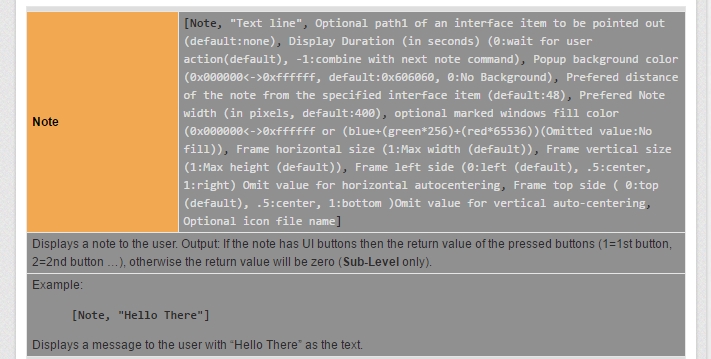

I am trying to write a Pie-menu-like thing in zbrush.
For that I want to call out note centered on mouse position.
Zscript command reference about notes left me with some questions:

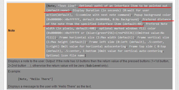

  1. What “Optional path of an interface item to be pointed out (default:none)” means and how exactly it works?
    2)Prefered distance of the note from the specified interface item (default:48) - Can I specify mouse cursor as an interface item and if yes, how?
If that was pointed out somewhere else, then I am sorry.

Hi Anton,
I’m afraid those two functions no longer work. The parameters have to be there - in other words you need to put the right number of commas into your zscript code - but ZBrush will ignore any values you put in. (In ZBrush 2 you could use a Note to point to a button or slider on the interface. It was a useful feature for tutorials written in zscript. But in later versions many of those features no longer work.)
