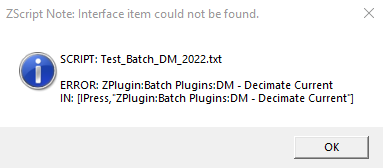

I have been working tirelessly on getting this to work in the latest version of Zbrush but simply can’t.
Either it spits out a decimated rhino, which is actually just the default sphere, or it presents me with the following error:

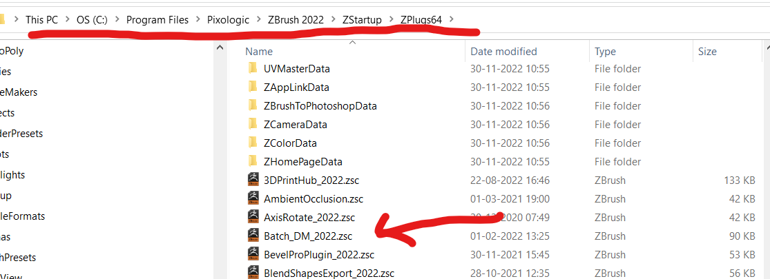

That error looks as though you haven’t installed the plugin correctly. Did you put the Batch_DM_2022.zsc file to the Pixologic/ZBrush 2022/ZStartup/ZPlugs64 folder?
-Marcus
Yup, right here → image

So do you have a “Batch Plugins” subpalette in the Zplugin palette, with a “DM - Decimate Current” button? And how are you loading the Test_Batch_DM zscript?
(I’ve just tested the posted version with the latest ZBrush and it works without problems for me.)
-Marcus
That’s just it - There’s no “Batch Plugins” in the Zplugins… I’m loading the zscript with the script loader as I usually do with my own scripts.
Hmm, that’s strange. Can you try loading the Batch_DM_2022.zsc file from the ZScript>Load button and tell me if you get any error messages?
Ok, this is indeed a strange behavior… I restarted Zbrush a couple of times and suddenly I had the “Batch Plugins” in Zplugins - BUT with two buttons to unwrap uvw, one for ‘current’ and one for ‘all’.
After another restart I got the “DM - Decimate current” but when I tried running the demo-script I got a Zbrush popup that told me it couldn’t find the plugin.
After yet another restart I can now run the script - This is so weird :crazy_face:
I’ll have to investigate and test further - Will return later!
