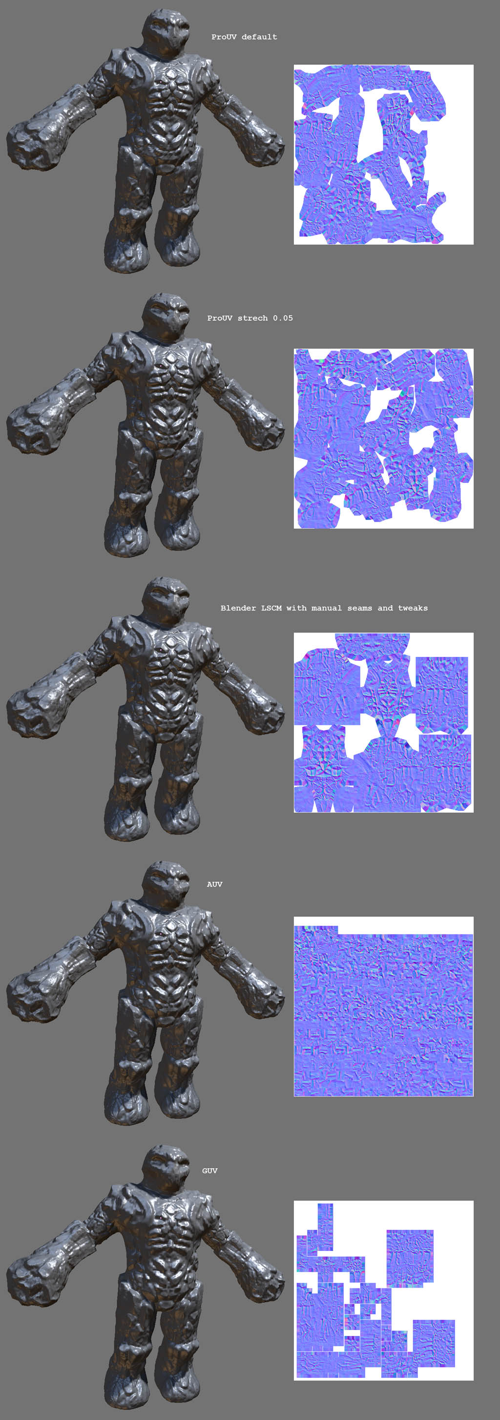

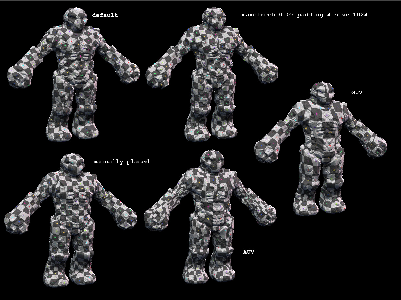

done some tests myself on a full character just to see how it held up with normalmaps using blenders glsl shaders.
the default settings might have a bit to much stretching going on but after some tweaking it actually looks quite good i still prefer the one i did manually in blender tho but for just a single click not to bad
 [[ATT=]UVComparison.JPG[/ATT]](http://javascript%3Cb%3E%3C/b%3E:zb_insimg%28%27%27,%27UVComparison.JPG%27,1,0%29)
[ATT=]UVComparison2.JPG[/ATT]
Great stuff, its holding quite good compared to boring manual unwrapping!
