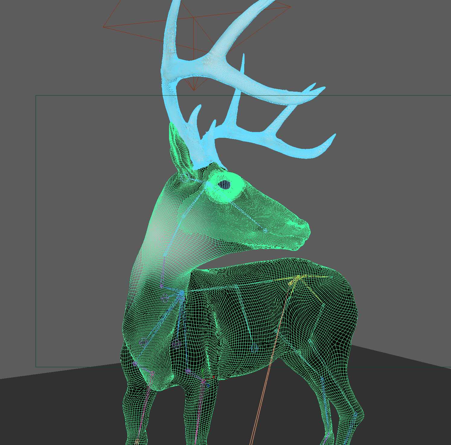

Hi @louvfx ,
I don’t know very much about what you’re doing, but from what you describe:
I would not. Unless the two parts are supposed to be visibly separate, you’d get the best results posing them as part of the same mesh.
As above, unless you mean the teeth. Teeth and eyes typically are posed as separate meshes.
For the type of animation you describe it sounds like traditional rigged animation would be best. Blend shapes like 3D layers in ZBrush have limitations for the purpose of animation. It sounds like you want to animate both the pose of the head as well as the movement of the jaw at the same time.
