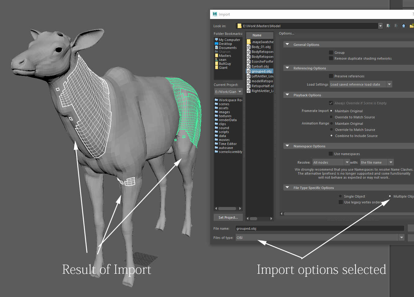

Hi Marcus, and thanks for getting back to me, much appreciated. I have done that, but it brings in many more groups than are in the original object.

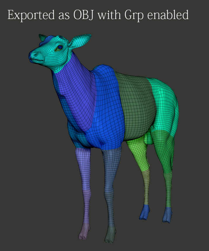

Here you can see what I’m talking about. If you (or anyone else) could test it on your end that would be amazing, just to be sure it’s a bug, in which case I can log it.
Again, this is using Maya 2018.5. And the same thing hapens if I turn on Legacy vertex ordering. It wouls seem strange that it would be an Import bug, which is why I’m thinking it might be a ZBrush Export thing since the Grp option was moved to the Preferences. (I’m using ZBrush 2021.7.1)
ExportFromZBrush result
