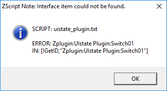

  5. yes but it always tell me the interface could not be found ,even when the startup routine is possitioned before the UI.

This version also has an error in the memblock naming - the block created using MemCreateFromFile has a different name. So the switches memblock is not created.
I’ve no idea why the version I sent should give problems but I suspect you’ve got a conflict somewhere in your installation. I’d check what you’ve got in the ZPlugs64 folder. This method is the same as for many Pixologic plugins which generally work without problems. When they do cause problems it’s invariably because the user has an old version also installed, or some other conflict.
yes sorry i did that mistake again when preparing the zscript for you.
But actually even with that fixed, the script cannot found the switches.
i cleaned up the Zplug64 directory, removing all plugin which are not official.and deleted the zbrushdata directory and restarted zbrush. nothing is solving the issue i get.
but know you say that , i tested to remove my own plugins , which are a number of 6, and i can hot reload the uistate plugin now :wink:
i keep you posted about the progress on that , thx you Marcus :wink:
