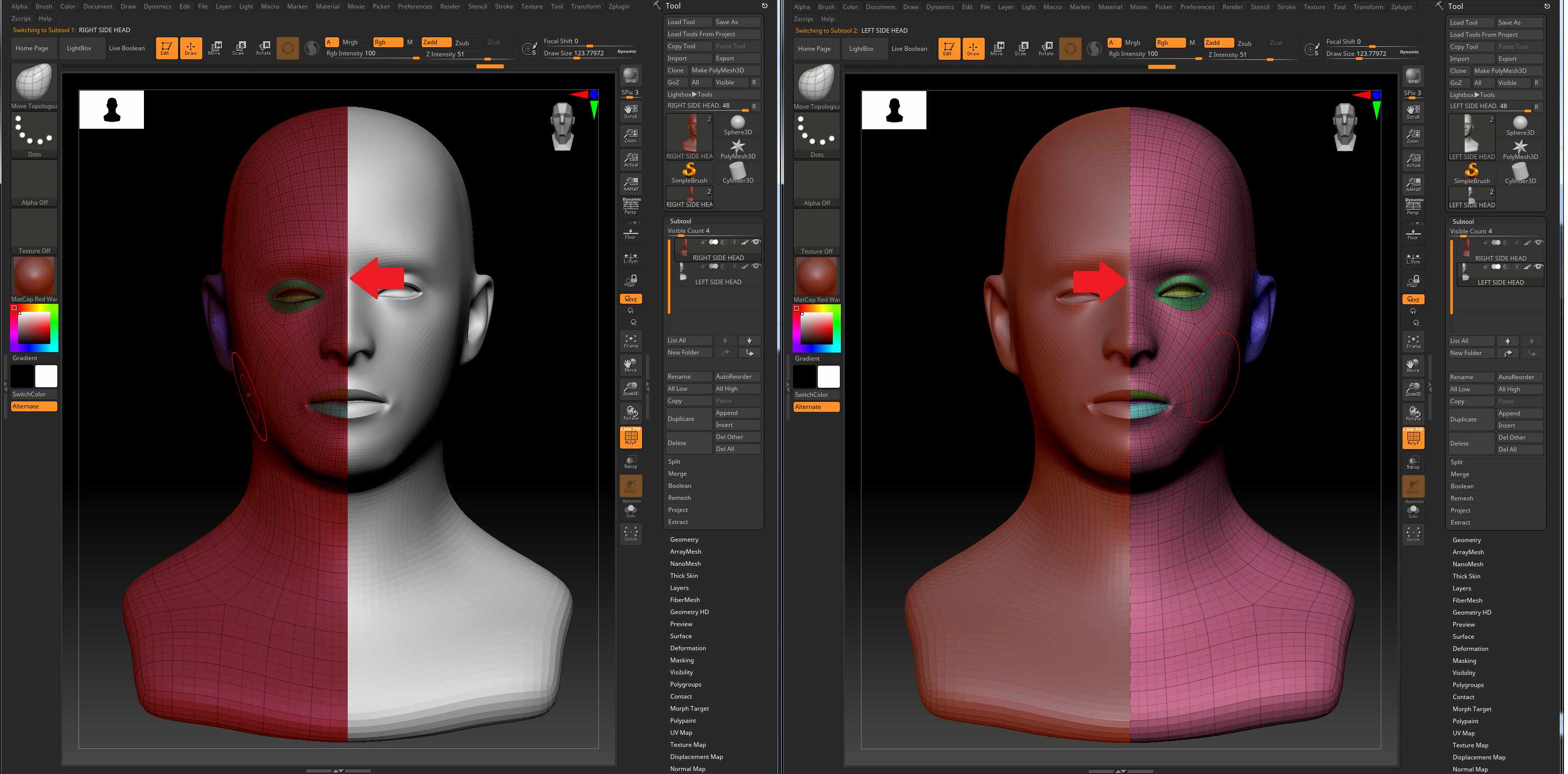

Let’s say I’m working on a human head sculpt.
I duplicate an instance of the human head sculpt as a separate subtool.
One subtool will be turned into the right side of the human head. The other subtool will be turned into the left side of the human head.
I turn off symmetry.
I use the selection tool to hide the right side of the face from the center of the left heads model. I turned symmetry back on.
I do the same thing to hide the left side of the face on the right sided human head version of the model.
The visibility is turned on for both of these subtools. So they appear and look like a single head in the viewport display in Zbrush
I’m able to sculpt between the left and right sided subtool versions of this head with symmetry turned- The brushes will affect the hidden portions of each mesh because active symmetry is turned on for both models.
It will keep the center polygons trapped to the center where they need to be between both models.
There’s no need to commit to any changes that you make to either side and there’s no severe deformation made to your mesh that you can’t undo.
Making it easier to revert back to any previous sculptural changes that you made to either side.
Obviously once you’re pleased with your changes to the left and right side versions of your model you can combine them into a single object by deleting the hidden portions and merging them into a new mesh or by using the morph/projection brush features of Zbrush while masking off the other side.
Being able to do this for a human head sculpt is one such example of it’s use. I can think of lots of other things I could use this feature on to improve my workflow and get the desired results I want out of Zbrush.
So basically this Plug In will let the brushes effect the hidden portions of the models geometry after symmetry is turned on.
Marcus Civics if you see this and you think you could do it I’d really appreciate it.
I hope it’s possible.AFFECT WHILE HIDDEN
Edit: (Response) the feature is intended to support the ability for the brushes to affect the hidden portions of the active subtools geometry when symmetry is turned on. Basically this feature or plug in will let your brushes affect the hidden topology on your model as if it hasn’t been hidden at all.
Essentially making that hidden portion of the model still editable as if it wasn’t hidden at all.
The image I’ve included roughly explains how you could use this to move away from symmetry on a human head while still keeping the active symmetry function on each individual subtool.

Hello @Charles_Roberts,
If I understand you correctly, you are asking for ZBrush to be able to sculpt on multiple subtools simultaneously in real time, not hidden geometry? ZBrush cannot do this on a fundamental level, and this cannot be changed with scripting. I’m only guessing, but I imagine you could automate the process of mirroring the geometry to a separate subtool after sculpting on one side of the face.
In order to be able to sculpt on sections of mesh at the same time in real time, those mesh sections must occupy the same subtool, using the traditional methods of polygrouping, masking, and hidden geometry–which is a feature designed specifically so that the hidden portions cannot be affected by sculpting operations–to control which portions of the mesh can be affected.
If I am not understanding your description, or if you are working for a certain type of output that you believe the above cannot achieve, please elaborate. There may be a way to do what you want to do. Center lines can always be reestablished and re-centered, and many non-destructive workflow options are available–for instance by saving morph targets, or an earlier version of your mesh, layers, projection, etc.
Otherwise this would be a feature request for ZBrush itself, which can be submitted to Pixologic Support the same as a plugin request. This would not be a simple change to the program, however.
Thank you!
This doesn’t really warrant a plugin but here is a macro that will help you work in the way you want.
  1. Save the file to the ZBrush 2021\ZStartup\Macros\Misc\ folder and press Macro>Reload All Macros. You will then have a new macro button called “TransModel”.
  2. You must have UVs assigned for this to work.
  3. You also need to have hidden part of the model before pressing the macro button.
Download here:
TransModel.txt (1.0 KB)
Important Note: This works by creating a texture map with pure black which ZBrush then renders transparent. You can’t use polypaint - the macro uses “FillColor” so any polypaint will be erased but also with a texture map on your model you will not be able to see polypaint if you paint it.
HTH,
Marcus
