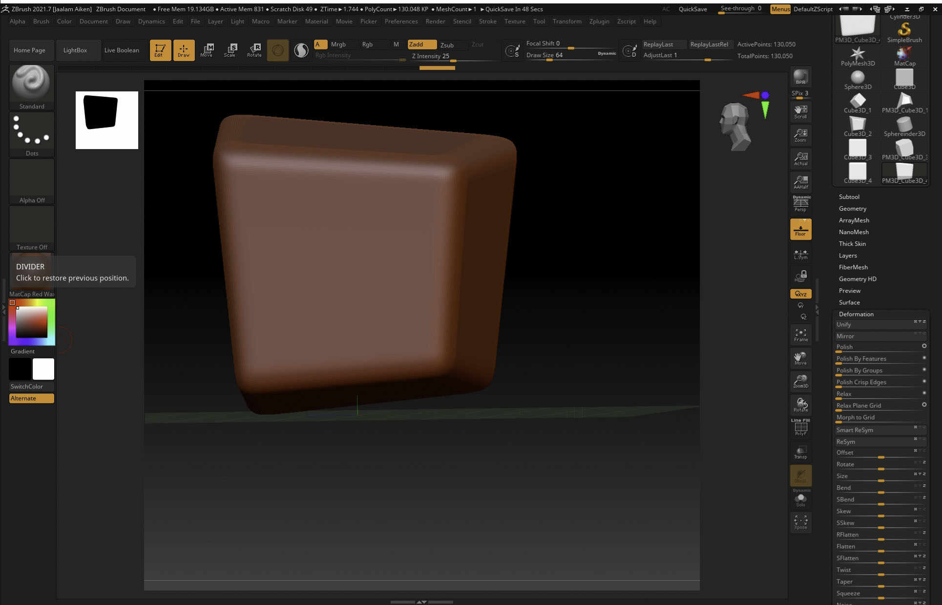

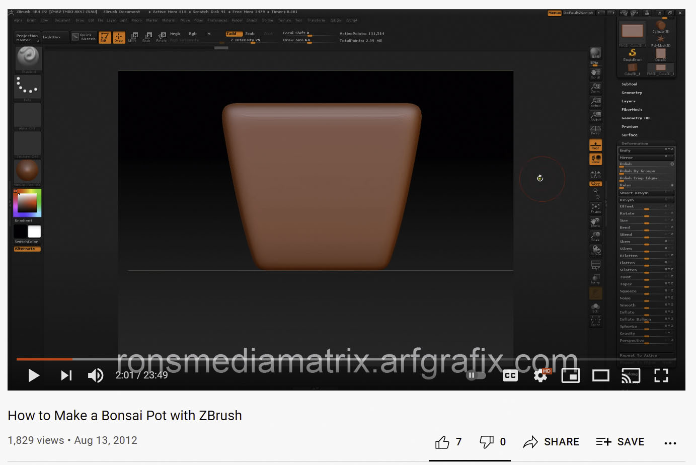

I am trying to follow a beginner tutorial but when trying to use the taper slider it tapers nothing like the tutorial one does. Can anyone tell me if this a program error or am I missing something simple? My cube is tapering from a corner rather than from the bottom of the cube. mine tutorial

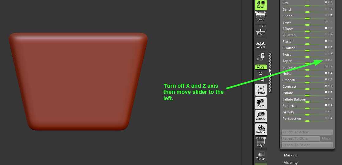

It looks like you are tapering all 3 axis at the same time. Only the Y axis should be selected so you are tapering that one only.

Thank you that worked! The tutorial was showing all three selected which is very odd. I appreciate you taking the time to help.
