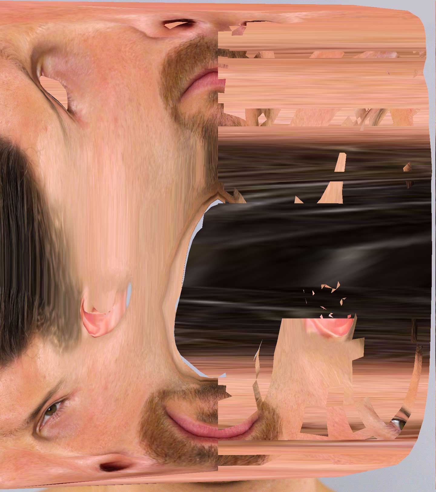

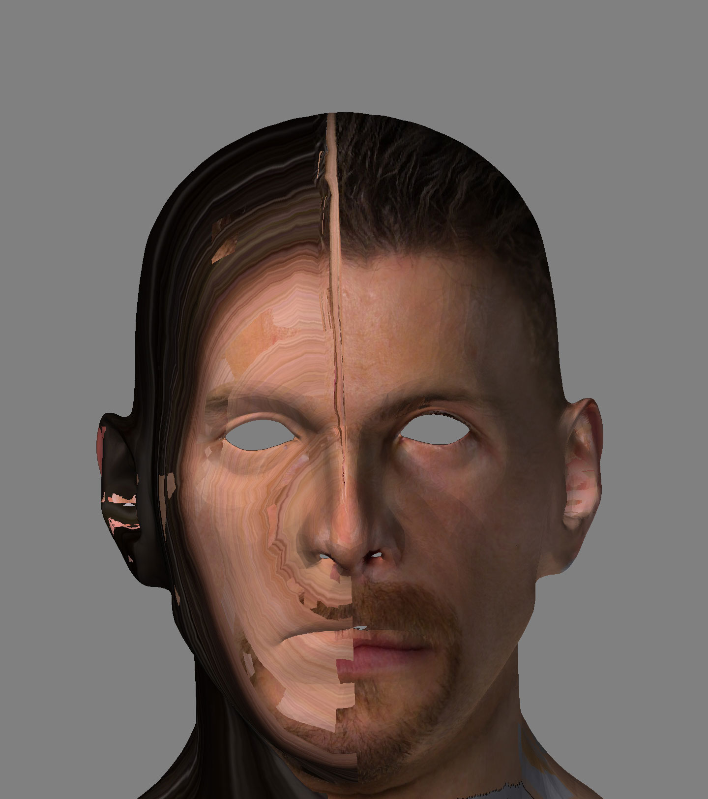

i tried this tutorial, about texturing whith image plane,
and i still whith a big problem, maybe you can help me,
in my example,i don’t have a three quarter view image,
so, i flipped the side image in photoshop, and i cloned the texture beetween
each steps, but the other side i did before, is destroyed and twisted…
and very bad seams…
why?
Good tutorials !

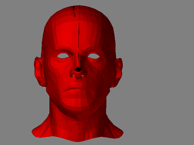

it looks to me that your uvs are messed up (overlapping) how did you do them? if you didnt need to edit the uvs in a 2d package you could just use tile uvs in zbrush, but i recently followed this tutorial and you need to piece the projections together. what i think you need to do then is export your lowest sub division into max or some other 3d package and do your uv layout in their and then import it back to zbrush for it to update your uvs, its fairly easy to make and check your uvs in max. thats what i used and iv just finished the texture process today with it working fine. if you search for “exploding mesh” in the main forum their is a link to a thread where i wrote down the process i took to do this to ensure the mesh doesnt explode when you re-import it to zbrush (as stated on that post i dont take credit for that, theirs two other very clever guys on the post who sorted it). also if your new to uv layout google a guy called “eric masouwski, organic modeling”, hes got a great tutorial for the basic concept. hope this helps
i strongly recommend you check the explode mesh link as this will save you a lot of trouble
p.s im a noob so their may be a better way to sort this
