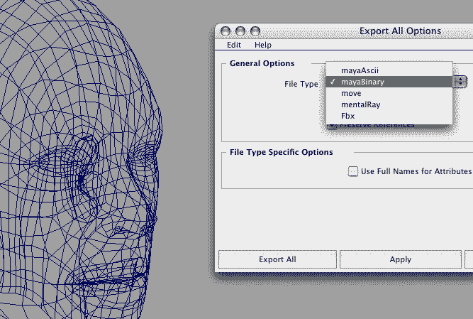

Moka - the OBj exporter in Maya is not always turned on and so not visible in the export options.
I think the place to turn it on is in the plug-in manager which is under Edit: Preferences.

Ryan … you are more than a mentor… you are a GURU !!!
In Maya Window -> Settings/Preferences -> Plug-In Manager
TANK YOUUUUUU

There is an export OBJ plug-in for Maya. I tried to get you a link at HighEnd 3D but I couldn’t find it. Have a look in your plug-in manager in Maya. I am not sure if it comes as standard but not loaded.
I didn’t see that Ryan had beat me to the answer.
