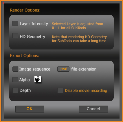

Here are the features of Turntable Plus
[attach=114534]interface.jpg[/attach]
Layer Intensity
This feature will allow you to render a layer in your turntable. It will only render from intensity 0-1 and will only render the selected layer.
HD Geometry
This feature will allow Turntable Plus to render out a turntable of all HD subtools.
Image Sequence
This feature will render out an image of every frame of your movie. This is much like taking a GrabDoc of every frame of your movie.
Alpha Sequence
This feature will render out an alpha of every frame of the movie.
Depth Sequence
This will render out a depth image of every movie frame.
File Extensions
Turntable Plus will export Image, Alpha, and Depth sequences in three formats. (tif, bmp, and psd)
Disable Movie Recording
There will be no movie to view or export from ZBrush if this option is selected.
