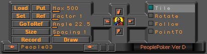

New with PeoplePoker Version D
Fixes:
Fixed Problem with Sizing
Enhancements:
Load: You can now load just a single Zsphere Tool without an incremental filename i.e. MyModel.ZTL.
You can now load Incremental Filenames with either a 1 digit or 2 digit index
i.e. MyModel1.ztl … MyModel9.ztl
or
MyModel01.ztl …MyModel15.ztl
Note: 1 digit and 2 digit indexes can not be mixed
  GoToRef: Move Model to Last Reference Point. This might be needed when you switch to a different set of models that are scaled differently than the current sizing. Move a new model to the Reference point and then Size it to scale with the rest of the canvas. Then Press "Ref" to save the new scaling. This way you can keep everything related to a certain scale.
  Tile: Set Tile switch to on and use the Navigation arrows to place the models in a grid pattern left/right/up/down from the last. Use the "Spacing" slider to control the space between. A Spacing of 1 equals the height/width of object. You can use Rotate, Follow, or PointTo functions to further modify the positioning of the models.

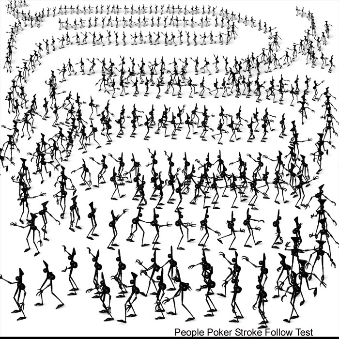

  Record: Press SHIFT 'b' to select the simple brush and draw a brush stroke on the canvas where you wish to place your models. Then press the "Record" button to save the brush stroke.
  Draw: Put your models onto the canvas using the data from the recorded brush stroke. Spacing is determined by the Spacing Slider. You can use Rotate, Follow, or PointTo functions to further modify the positioning of the models.
  Spacing: Set the Spacing slider to modify the spacing used by the Tile or Draw functions. Setting of 1 = height/width of model. A setting of 2 equals height/width of the model X 2
  Model Display: Shows the name of the Next model to be placed. Use the Fwd and Back buttons to scroll thru the model list to select the next model to be used.
Feel free to ask any questions. You don’t have to use people type models to poke, you can poke trees, mountains, skulls, hair or anything else you want to put on the canvas and scale them to the rest of the canvas according to zdepth.
Have fun you Pokers!

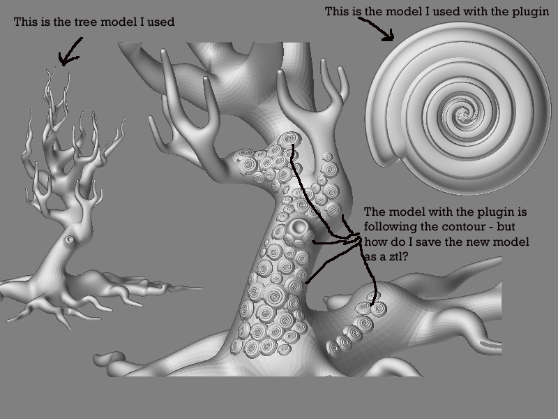

I do not know if this can be done with the plugin please let me know.
I have loaded a tree ztl which I saved as an obj then re-loaded into zbrush. I created a ztl like sprial that I load in the plugin and it works cool - places the celtic like circle onto the tree. However I can not get the tree and the model used with the plugin to become a ztl. How do you do this?
Apologies to Digits for my butting in here - I don’t think you can do what you want with PeoplePoker unless you mark as you go, but you can do it with MarkerMaster (see my signature). Basically you need to mark the tree, and all the spirals as you go, then use the Multimarkers tool to make a composite mesh. My plugin makes the whole process relatively painless. :slight_smile:
I don’t know if this is possible, but you might want to try running the script while the model is dropped in projection master.

Thanks for the continued interest. Actually I posted a version on page 1 of this thread that will create a marker for every Poke.
Good idea Lemonado, your wish is my command.
Just turn Mark ON and every thing you poke will generate a Marker. Word of caution if you are using High Density models the polymesh you will create may become huge.
Thanks for the suggestion.
PeoplePokerD_Install.zip
                                                                        __________________
Give that a try and see if it works for you. As I mentioned you will have to experiment because your obj file mayperhapspossibly become to huge to handle. Let me know how it works out
Digits
