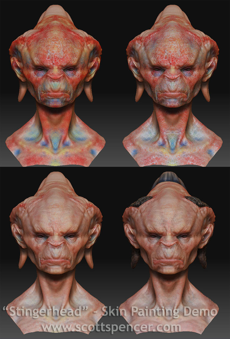

To help clarify the stages this image shows the underpainting, motteling (noodling) layers, and then mists of flesh color to the final.

A quick breakdown of the process is as follows
polypaint fill a base color on the model
using a dot alpha set to spray stroke with the color modifier set to 0 spray reds blues and yellows on the whole head
I isolate these based on color temapture zones on the face.
warm: cheeks, ears, nose, chest, sometimes neck
gold/yellow: forehead, areas where the skin is thinner and bone is close to the surface, bridge of nose, clavicles, temporal ridge, chin
cool: beard line , lower jaw, temples, recesses
once these overstated colors are blocked in I cover the entire head with a fine layer of little white squiggle lines
once thats done I switch to a skin shader then with a standard brush set to a VERY low opacity ( 3 or 4) I mist a version of the base color over the whole head. This pushes all those colors back into the skin.
I think switch back to the spray brush and add in reds, blues, yellows, and cool grays where needed.
IN the end I use cavity masking to paint into the detail a light warm brown.
Hope that helps a bit. I really will do another one with teh whole menu system visible next time. I was talking while I did this one so I didnt think to record thw whole screen.
S

Wonderful video. How would you create an SSS (Sub-Surface Scattering) effect such that the ears and nostril flares and horn edges would seem to possess qualities of translucence? Your interpretation of color zone theory is attractive and successful.
When you go into the tight close-ups of the eyes and face, what exactly are you doing?
One of the more interesting techniques is your masking of the horns around the 14 minute mark (anyway, it looks like masking, maybe you’re painting with dark grey). What are you doing?
Can you explain ‘Cavity Masking’ a little more?
Lastly, how accelerated was your recording session? How much ‘real time’ did the 17 minute video represent?

When I zoom in I am adding little noodles of white or beige as well as spraying a warm or cool gray to alter the temapture of the area.
As for the SSS effect I do switch to the skin shader near the start of the video and I paint on that. The painting technique does help to support the feeling of translucent skin. It isnt going to create the same kind of backlight effect you get in a proper SSS render or a sillicone head. To get that you need to do a mental ray render. One cool thing about a color map like this is that it works really nicely in a SSS render in mental ray.
As for cavity masking what it does it masks out the recessed of the figure. Go to tool:masking:mask by cavity to see what I mean. I painted on there with a cream color with the low areas cavity masked,
Th video is sped up by about 50% I took a little under an hour I guess, maybe an hour to paint this guy.
