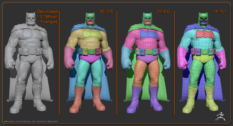

NEW! An in-depth look at the "ZRemesher" with Joseph Drust
The wait is over! Joseph Drust is back to share this new video on an in-depth look at the ZRemesher in ZBrush 4R6.
Here are a few key points that will be covered:
  • [i]symmetry [/i]options
  • using the [i]alternative ZRemesher algorithm[/i]
  • controlling target polygon count accuracy with [i]Adaptive Density[/i]
  • using [i]frame mesh[/i] to create precise control curves for re-meshing
  • using the [i]adaptive size[/i] slider, to control polygon density based on sculptural detail
  • using [i]polypaint/color density[/i] to control how the ZRemesher calculates the density of your sculpt
[youtubehd]9HWIMtEtDwY[/youtubehd]We hope you enjoy this video. Happy ZBrushing!
