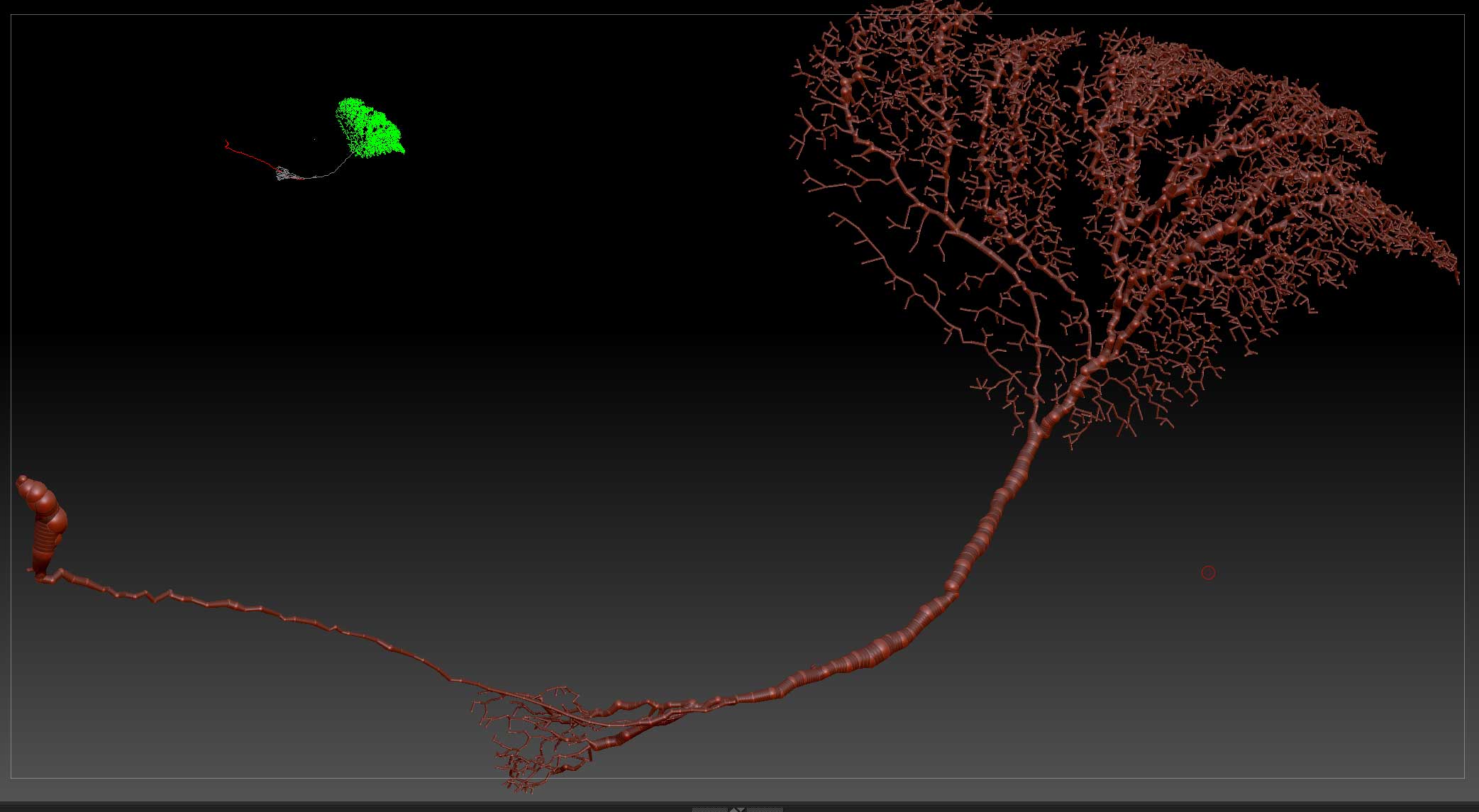

I’ll look closely at what’s happening when I have a moment but I think it should be possible to get this working. (Though whether it’s possible to get a really clean mesh remains to be seen…) There’s something strange going on with your file example that I’ve yet to solve. There’s also a general issue of scale - it’s necessary to reduce the size in order not to hit a limit where everything gets truncated. But I got this result with a file I downloaded from the site you give:
That looks very promising… and thanks for following this up! Do you happen to know which file you chose? I can check it to see whether this is the expected topology…
What scale factor did you use to keep it within a reasonable size?
I’ve also been think that ZSpheres may not be the best modelling approach. Creating curves meshes may be better, though I’m not sure you can taper those programatically…
Many thanks again!
Here’s the file:
I used a scale factor of 30. But it needs to be calculated on a per-model basis. Put in 20 and you’ll see the result!
What did you change in the script to get to that point? Did you add a “scale factor” variable and divide all the dimensions by that?
Many thanks for following up with this…
And what do you think would be the best geometry approach, because even with the successful zsphere model, there doesn’t seem to be a way to get a usable mesh from it without crashing ZBrush…
Here is the modified script. This works for me. It includes hack for getting the scaling factor and also loads the zsphere as necessary. I don’t get a crash when previewing the mesh but the file you posted has issues with stray points/zspheres.
