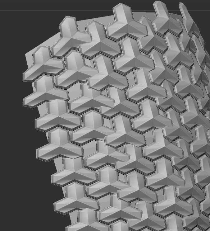

I have a curved mesh that I’m applying an armor patter on using nanomesh:
I remeshed it a few times to make sure the polygons are as square as possible, though its of course not perfect resulting in a bunch of issues using nanomesh, such as these:
As you can see in the middle its pretty okay, but at the edges where its curved things get spaced out wrong, stretched, …

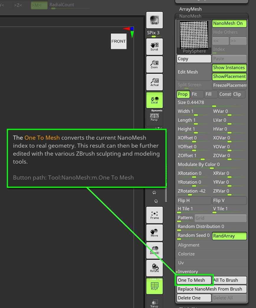

If you manipulate it while it’s still a NanoMesh then you will get that kind of distortion. You will have to convert it to a mesh before you manipulate it. You can use “One To Mesh” in “Tool > NanoMesh” “Inventory” to convert it.

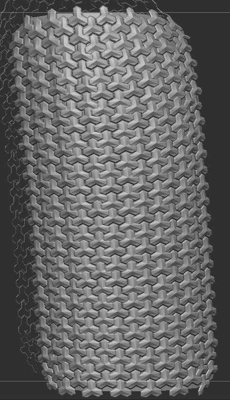

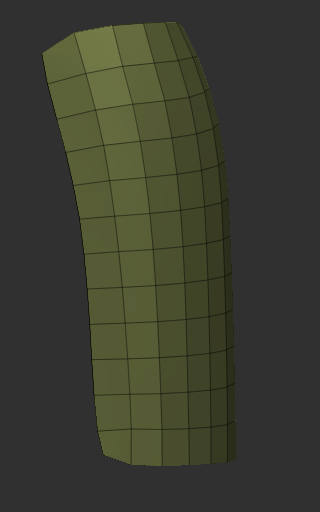

You adjust the NanoMesh to where you want it before you click “One To Mesh”. In order to adjust the NanoMesh, the underlying geometry has to be perfect. You can’t just create a mesh with different polygon sizes and shapes and apply NanoMesh to that. It just won’t work well, especially when your using a complicated shape as the one you are using for the armor. As an example, say you wanted to make a sleeve. You would start with a Cylinder primitive and use “Tool > Initialize” to get the polygons around the outside as square as possible then remove the end caps. Apply your NanoMesh to that and adjust them so they fit perfectly. Now, you would click “One To Mesh” in “Tool > NanoMesh > Inventory”. Now you can manipulate the mesh to the shape you want.
Alternatively, and this would probably be the easiest route, if you want to make an Alpha and use that with UV’s and NoiseMaker, you can select a Plane3D and adjust it to as many polygons you want. All the polygons will be perfectly square and will work really well with NanoMesh. Once you have adjusted the NanoMesh fit, click “One To Mesh”. Now set that mesh on the canvas using Shift to snap it to an orthographic view, then go to “Alpha” palette and click “From Mesh” to create your alpha. Use the “Size” slider to get the size you want then click “OK”. Save the Alpha. I hope this will clear it up for you a bit better.

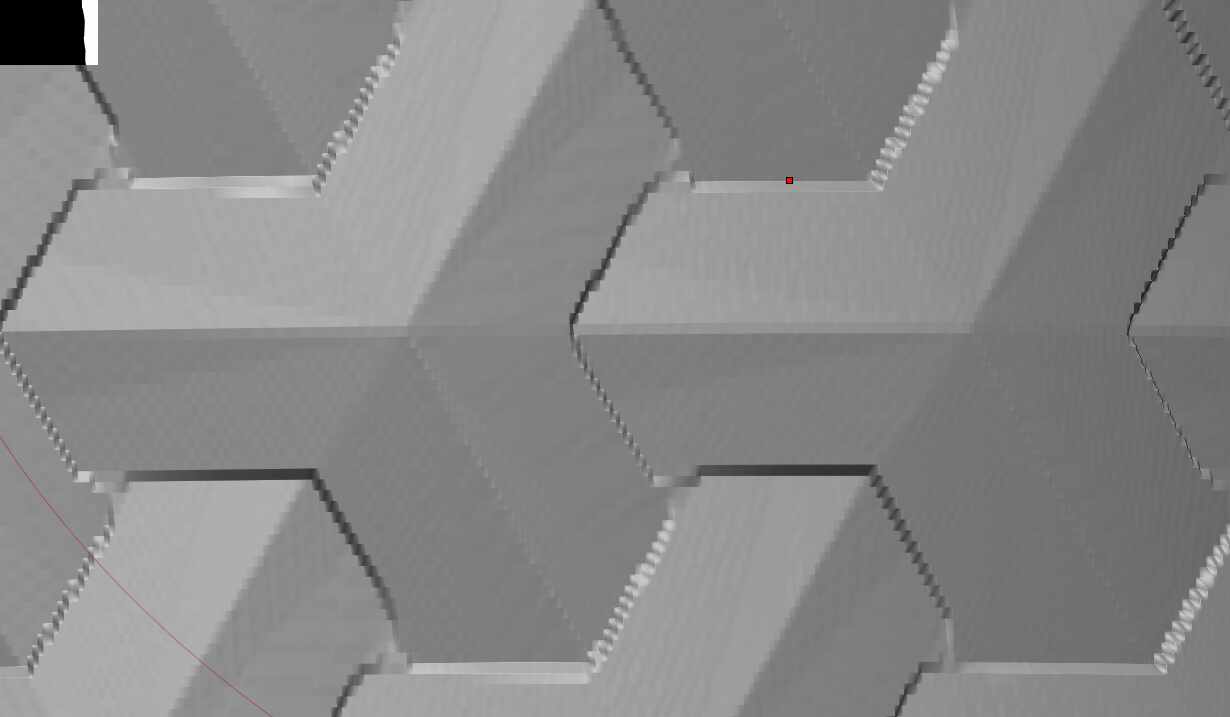

That works pretty well, the problem is my alpha turns out pretty pixelated, and for it to be a good resolution I need a crazy amount of polygons

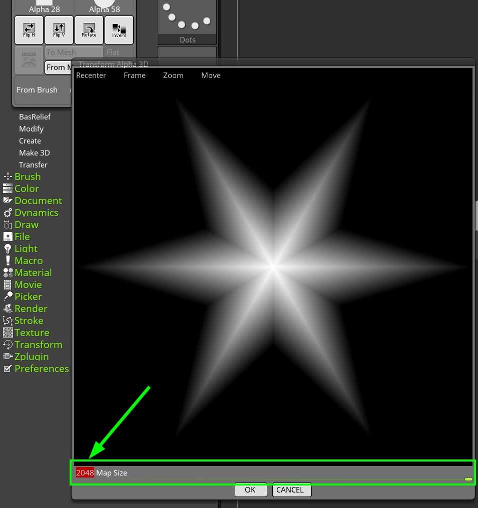

You are going to have to make some sacrifices somewhere if your computer can’t handle it. Like breaking down parts into more subtools. Doing that, you can add more details per subtool. Did you max out the Alpha size to 2048 x 2048 to get the most detail?
