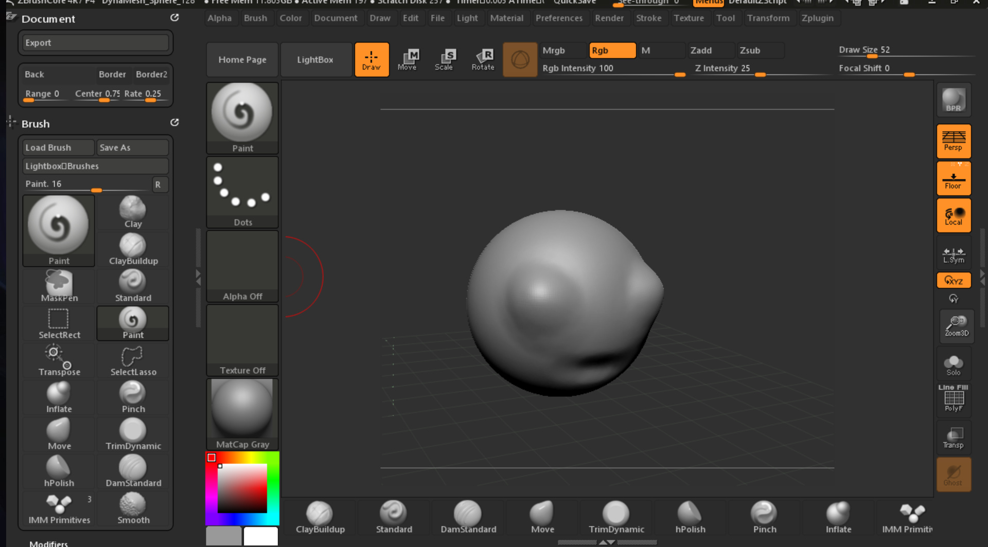

My ViewPort is too small and I can't change it in the Document tab. Zbrush Core
can'tChangeViewPortSizeinDocument.PNG.jpgcan'tChangeViewPortSizeinDocument.PNG.jpgcan'tChangeViewPortSizeinDocument.PNG.jpgAs I am new to Z-brush Central I guess I can’t add pictures so I will do my best to explain what’s going on. Basically when I minimize my side bars my workable view-port doesn’t change size. So if I open both side bars it makes the workable view-port extremely small.
When I search online it says to go to the document tab, and change it there. However, in the document tab, it doesn’t have the option.
I am using Z-brush Core so it may have been changed from the original Z-brush. If so does anyone know how to fix this?
Save your project if you need to, then press File>Revert. What this does is reload the project so that all the available document space is used. If you close the trays and palettes first the size will be larger.
