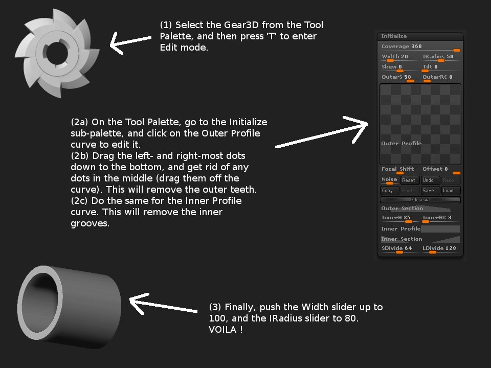

My First Ever Tute : Make A Hollow Pipe
Pretty basic and simple, I welcome your feedback :slight_smile: :slight_smile:
[attach=84749]Gear3.jpg[/attach]

There is a Coverage slider in the Initialize sub-palette. Set this to 180 (i.e. as in 180 degrees) to get a half-pipe.

You just choose a cilinder and Initialize the hole by inner radius.
And you now got that pipe.
