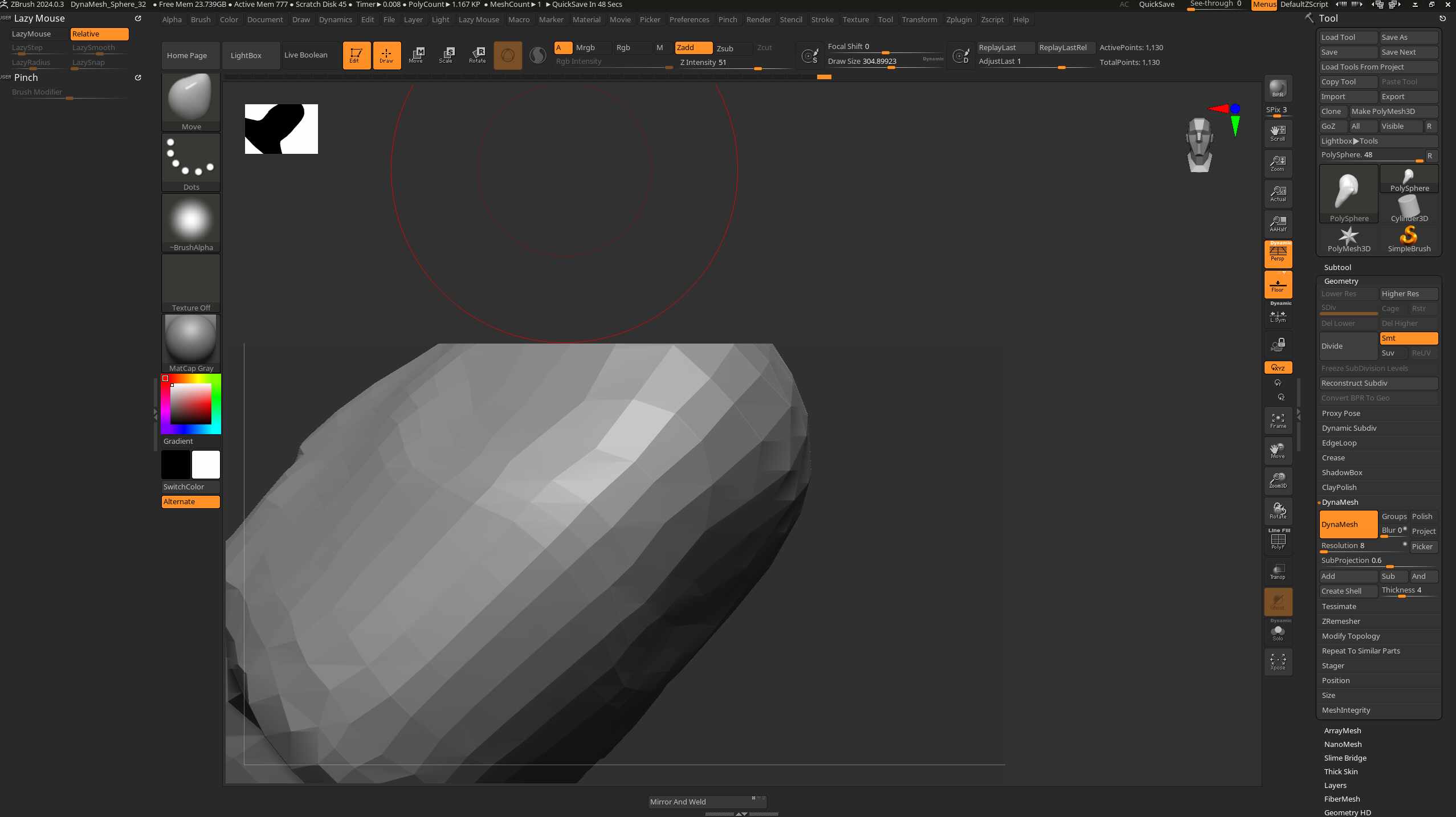

I don’t know what happened, but I must have hit the wrong key and my document size is messed up. I don’t know what button I pressed or how to fix this. Can someone please help? I attached a screenshot.

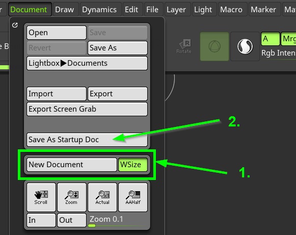

To fix it, do the following. First, clear the canvas by pressing Ctrl+N. You can redraw the Tool after you fix the document.
Go to “Document” menu and enable “WSize”. This will make the document the same size as your canvas area. Then click “New Document” and answer “No” to the (Document has been changed. Would you like to save the changes) dialog that pops up.
Click “Save As Startup Doc”

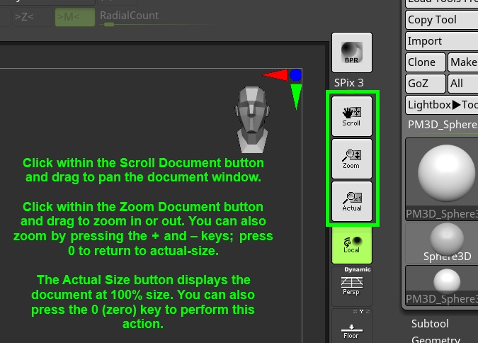

You also have the Document controls below.
