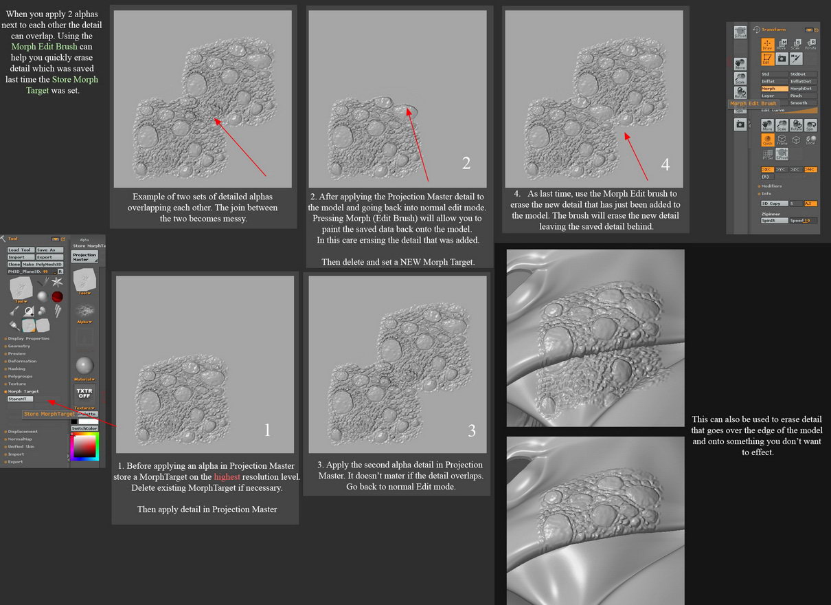

Morph Edit Brush mini tutorial
I only found this useful tool the other day and now it’s speeded up my work process considerably.
As others may have overlooked it, I thought I’d post up a small tutorial explaining how to use the Morph Edit Brush. There are lots more ways to get the most out of it, I’ve only pointed out the obvious. One thing that is good about this brush is how fast it is at editing the detail.
Hope it is of use to any of you.
  MX

Glad that this was of some use to you. I didn’t know if it was too simple to point out but these things can be overlooked sometimes. And it is very useful and beats applying details and blurring the info you don’t need.
