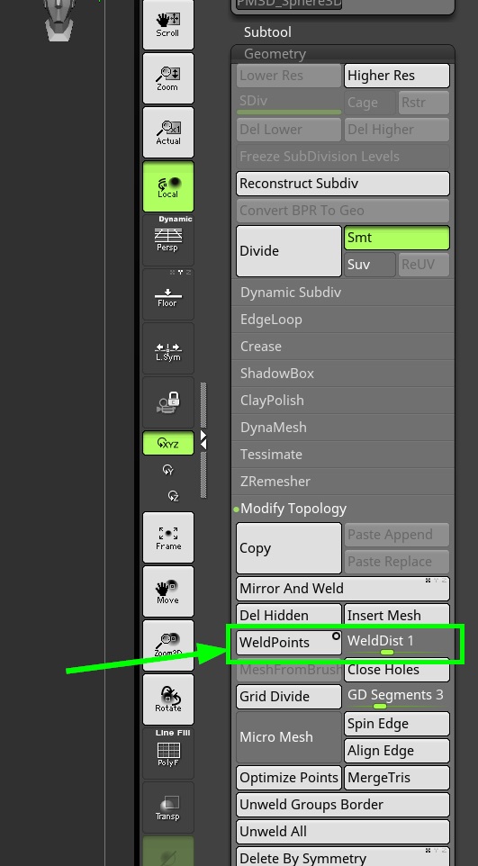

Hi @JTG
You do have points that are not welded. That’s why the mesh pulls apart when you subdivide it. Click “WeldPoints” before you subdivide the mesh. It’s in “Tool > Geometry > Modify Toplogy” (see image below)
2023-08-11 10_48_21-
Hey thanks! That seems to have solved it…
