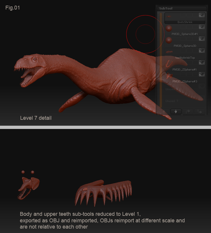

Current issue:
A mesh containing sub-tools that has been created in zbrush cannot be exported and reimported and maintian scale and position relitive to the other sub-tools. See fig01
Solution:
The perfect world isn’t here yet so you can’t sculpt your various sub-tools to differnt levels, export them at L1 and re-import them without them jumping. If anyone can figure it out please share, the scale bug might be corrected in 3.5 but until then here is our workflow:

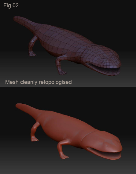

Do a quick twenty minute sculpt with Zspheres, to get the basic shape, then retopologise within zbrush to get a neat mesh with sensible edge loops and mesh flow.
( If you want to go much further detailing before retopologising I suggest you read up on all the threads; to sum it up it is possible, but with limited success, you can’t project very high detail methods and you are likly to experience many crashes and heart ache along the way )
Retopologise
Subject to many tutorials itself, suffice to say- think about how you want the mesh to be able to bend or animate.

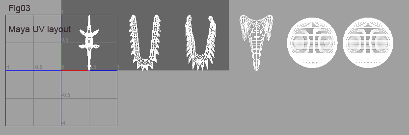

Import OBJ, add rows of simple teeth or anything else you prefured not to do in Zbrush. Separate each mesh you want as a subtool into a separate UV block ( 0-1 ; 1-2 ; 3-4 ) see fig03.
The UVing is simple projection for now and is temporary. Final UVing can be done later at any stage. Personally I use a combination of Headus and Maya to create UVs and I would do it at this point; I just havn’t for this tutorial.

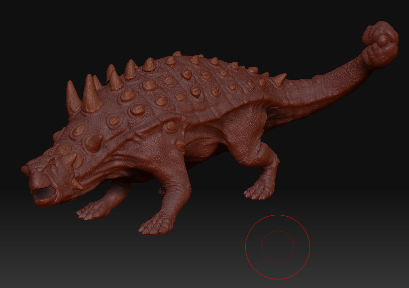

An example of this work flow solving problems is Fig04. & fig5 Here we have the many spiked dinosaur Euoplocephalus where it is clearly advantages to have the spikes as sub-tools, but in order to position it in an action pose you may choose to rig it in maya and reimport it. Certainly a maya rig is much more powerful than what you could achive in with transpose or prehaps you would want to create morph targets.
