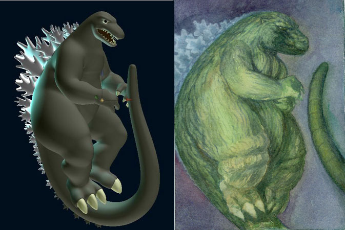

i’ve been waiting for z3 to work on my big-g model too, yours is looking great so far with the detailing. GMK was by far the best of the G films with the exception of the original, i decided to model mine on a watercolor i did. I’m interested to see how the multi-uv’s and polypainting work out. Maybe we can have a kaiju battle when we’re both finished. oh i made mine originally from zspheres then went into silo to add the teeth and spines also made with zspheres. godzilla1.jpg

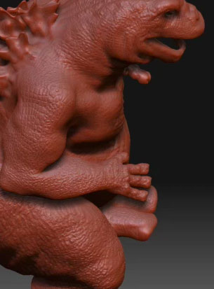

Spent the evening getting a feel for some of the new features in Z3. Learned to have a healthy respect for using the snakehook brush in 3D with 10k polys and 45 second undos.
Cavity mask + invert + gravity is a cool trick. Or inflate. Or both. I can think of a bajillion uses for cavity mask.
Still got a little bit of cleanup, and some unwise experiments to undo on the backspikes, but I’m pretty close to my “day 5” stopping point and I should have it up on the site this weekend.

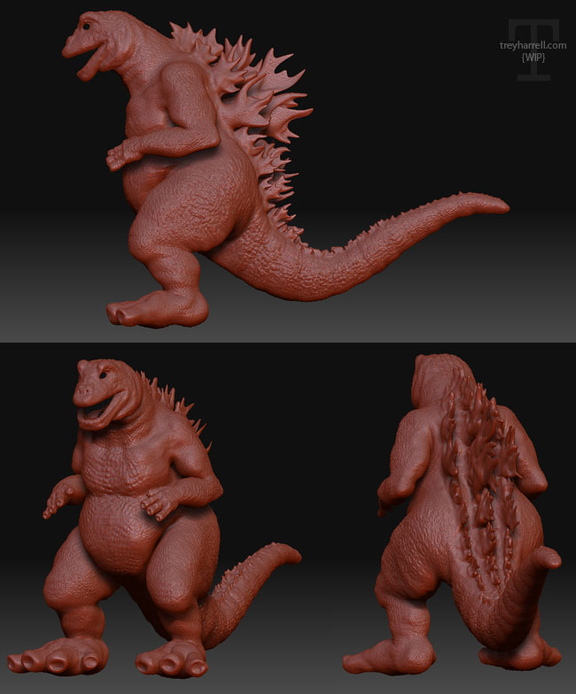

Anyhow, teaser image from where I’m stopping tonight and starting my day’s writeup:
this is looking great so far, just in case you haven’t noticed you can’t pose all subtools at this time so i hope when you add the teeth and nails that doesnt present a problem, at least thats what ive read. those spikes are so great, i love how organic they are, with mine i just copied one over and over, but i still havent done any sculpting on it yet, hopefully soon.
The teeth and nails aren’t worrying me at this point… it’s getting anything out of Z3 with sane UVs or any surface detail whatsoever that has me perplexed. I can do the accessories directly in maya.
