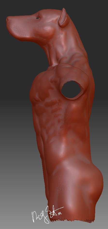

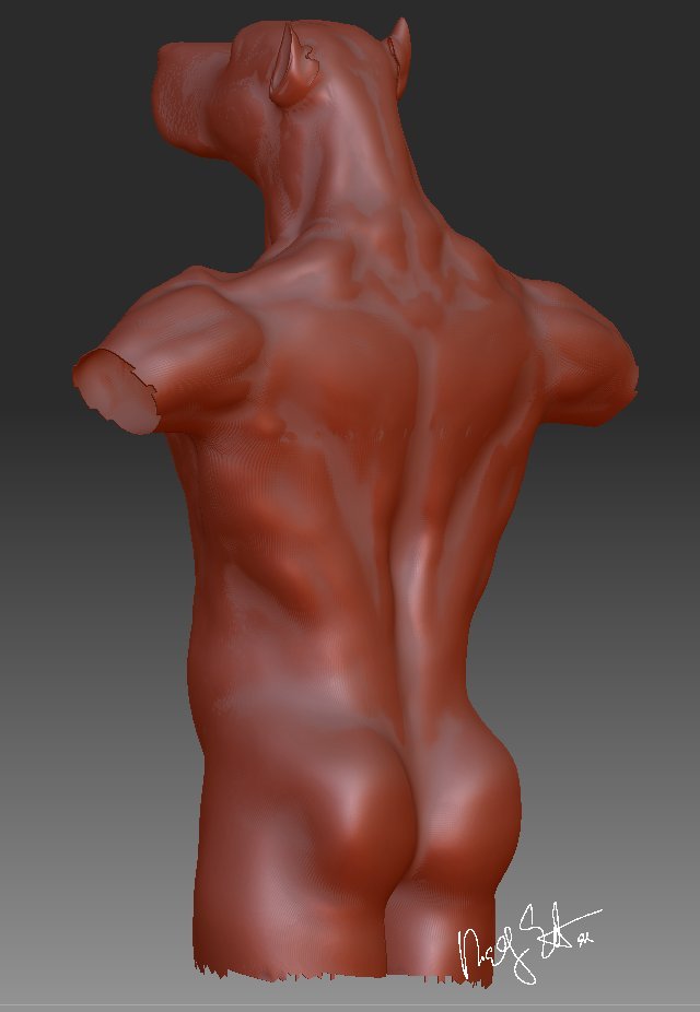

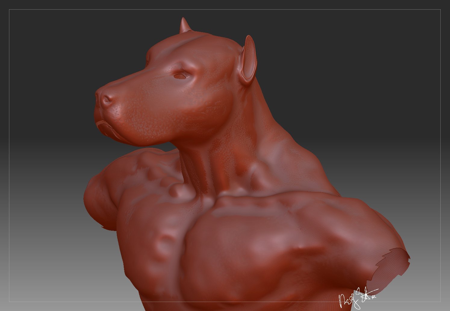

Here is the result:
One note:
The pictures above are only intended to show a more final-looking result at the end of the tutorial.
I 've done the muscleling and the skin-structure in about 5-10 minutes, so it is not absolutely anatomical correct (f.i. M.sternocleidomastoideus is here straight, not diagonal like in reality) nor a really elaborated work.:o
