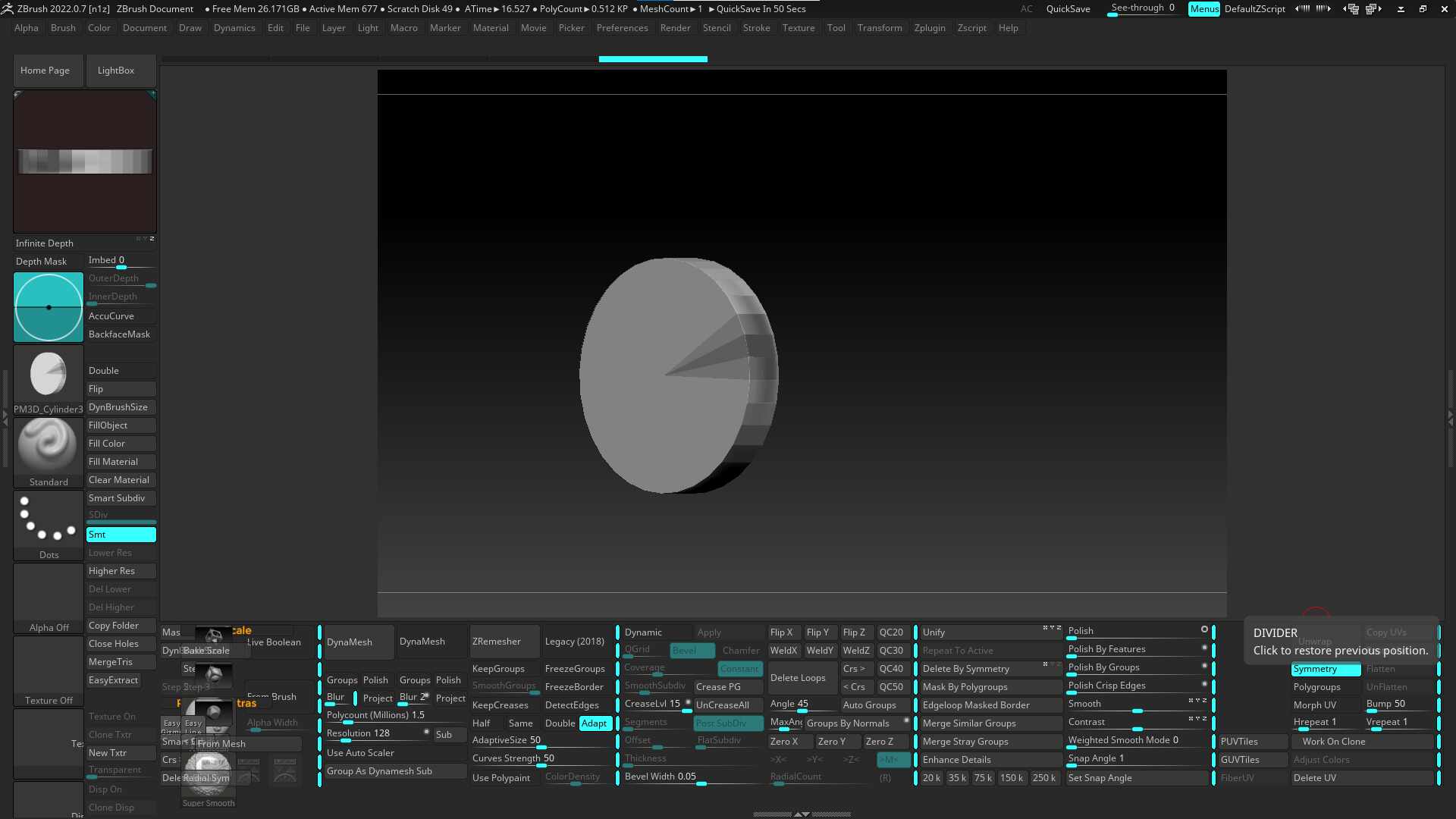

I have an issue with my Z brush I cannot mask. I have a customize UI and even with the regular UI Z brush masking don’t work and it is getting to my nerves.
That is how it mask.

Hi @Juan_Severino ,
Perhaps you could elaborate a bit more for me? I see visible masking in your screenshot. Please note that masking masks points and is dependent on your topology, so the fewer points on your target mesh, the less resolution the mask can have.
Is this what you’re having the problem with? If so then it’s just a matter of subdividing your mesh to higher resolution for higher resolution masking. Note however that the radial topology on your end caps wiil always tend to produce a radial masking pattern in that area. You would need to re-mesh the cylinder to have mostly square, evenly distributed quads in order to eliminate that effect.

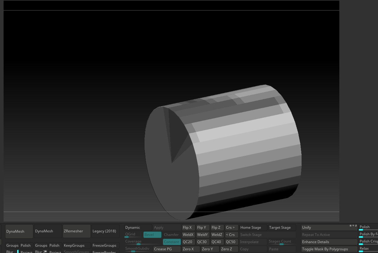

I am trying to do a tutorial on an UH-60 rotor by Henry Chervenka and when I try to do the mask after applying the dynamesh it won’t let me do anything only on that side as you can see.
