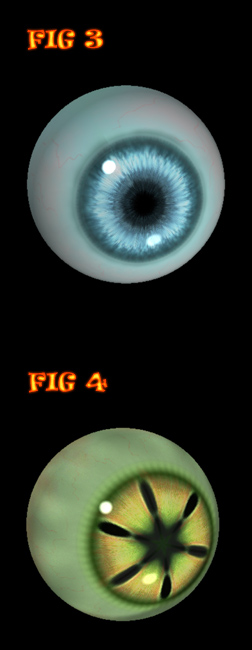

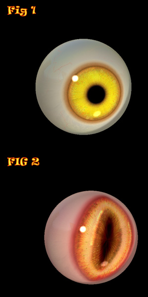

I have included two scripts that will produce the two eyes below. I suggest you turn SHOW ACTIONS on in the script menu and set the delay speed up really high if you have problems following along. Unfortunately I am not a script guru otherwise I would have attempted to annotate the scripts for you. The next step in the process will cover placement of the eyes and the prep/post work I do during that process. The third and final installment in this series will cover lighting and its affects on the other two preceding steps and how I accomodate the image to make it all work.
This file Eye Script.zip will create the eye in figure 1
This file Monster Eye Script.zip will create the eye in figure 2
