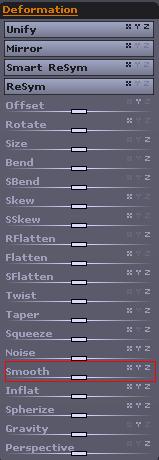

Here I changed the settings, so I’d have a nice angular-solid cube to work from. First, I went back to the Topology sub-menu and changed Subdiv to 1 and RigSmooth to its lowest value.
[attach=56707]ChocolateTutor14.JPG[/attach]

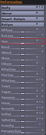

Step 18: Modelling the Chocolate Bar
My next step was to use the size slider in the Deformation sub-menu of the tool pallette to get the proportions of the cube to something right for a chocolate bar.  What axis you use might differ depending on what direction the cube was facing when it was being retopologized.
[attach=56723]ChocolateTutor18.JPG[/attach]

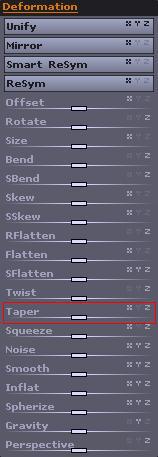

Next, I used the taper slider in the Deformation sub-menu to flare out the bottom of the chocolate bar a little bit.
[attach=56727]ChocolateTutor21.JPG[/attach]

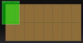

My next step was to select the top row of polygons in this group and hide the rest by using CTR+SHIFT+Left Mouse Click and drag.
[attach=56757]ChocolateTutor28.JPG[/attach]

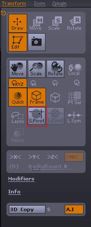

Right now the selected polygons are off-center, but I want the resizing to be in the center of the row of polygons.
What I did next was to go to the Transform Menu and press the S. Pivot (Set Pivot) button which will temporarily center the geometry around an origin point.
[attach=56760]ChocolateTutor29.JPG[/attach]

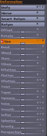

Step 28:
I went into the deformation sub-menu and resized the width of the polygons by about 10 percent along the Z axis (your axis may differ).
[attach=56761]ChocolateTutor30.JPG[/attach]

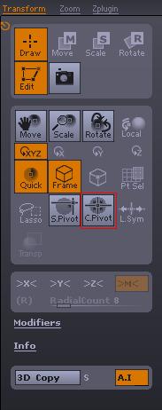

I went back into the transformation menu and hit the C. Pivot button which sets the center of rotation back to its original point.
[attach=56762]ChocolateTutor31.JPG[/attach]

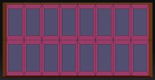

I used CTRL+SHIFT+Left Mouse Click again to make only the newest set of polygons visible. I used the steps posted above to make this new set of polygons wider as well.
[attach=56767]ChocolateTutor35.JPG[/attach]

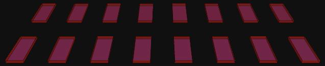

I selected the new set of polygons so only they were visible and used the Offset slider in the deformation sub-pallette to raise them a little bit higher.
[attach=56770]ChocolateTutor36.JPG[/attach]

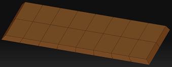

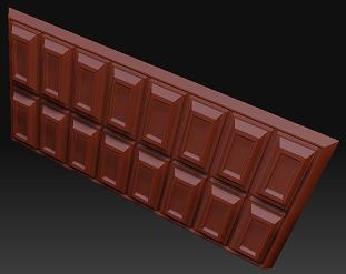

Step 39:
I wanted this new extrusion to be beveled slightly so I went into the Deformation sub-pallette of the tool menu and used the smooth slider.
[attach=56779]ChocolateTutor42.JPG[/attach]
Which resulted in this:
[attach=56780]ChocolateTutor43.JPG[/attach]
Step 40:
I used CTRL+SHFT+Left Mouse Click on an empty part of the canvas to unhide everything.
This is what I had so far:
[attach=56781]ChocolateTutor44.JPG[/attach]
Step 41:

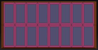

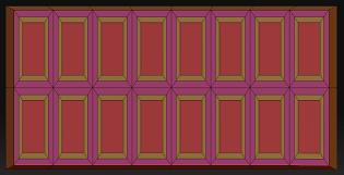

Now, I wanted to create a groove in between all of the segments of chocolate. I used CTR+SHIFT+Left Mouse Click to hide everything except the polygons bordering the segments.
[attach=56782]ChocolateTutor45.JPG[/attach]
Step 42:
I used Edge Loop in the Geometry sub-pallette of the tool menu to create a new set of polygons within these polygons.
[attach=56783]ChocolateTutor46.JPG[/attach]
Step 43:
As you can see, right now, this border is too wide for the type of grooves I want to make, so I used the same re-sizing techniques posted above to make them narrow. I resized using a value of -50. I didn’t need to resize the grooves around the outside edges of the whole mesh since I felt they were narrow enough.
[attach=56784]ChocolateTutor47.JPG[/attach]
The polygons that I used to extrude the grooves looked like this when I was done re-sizing them.
[attach=56785]ChocolateTutor48.JPG[/attach]
Step 44:
I then selected this set of polygons that I used to make the grooves using CTRL+SHIFT+Left Mouse Click until this was the only polygroup visible.
[attach=56789]ChocolateTutor49.JPG[/attach]
Step 45:
I used offset in the Deformation sub-pallette and then used the Edge Loop button in the Geometry sub-pallette to extrude the grooves inward into the chocolate bar a little bit:
[attach=56790]ChocolateTutor50.JPG[/attach]
The modelling phase is done! This is what it looks like:
[attach=56788]ChocolateTutor51.JPG[/attach]
Next step is working on the displacement map.
Continues in next post…
