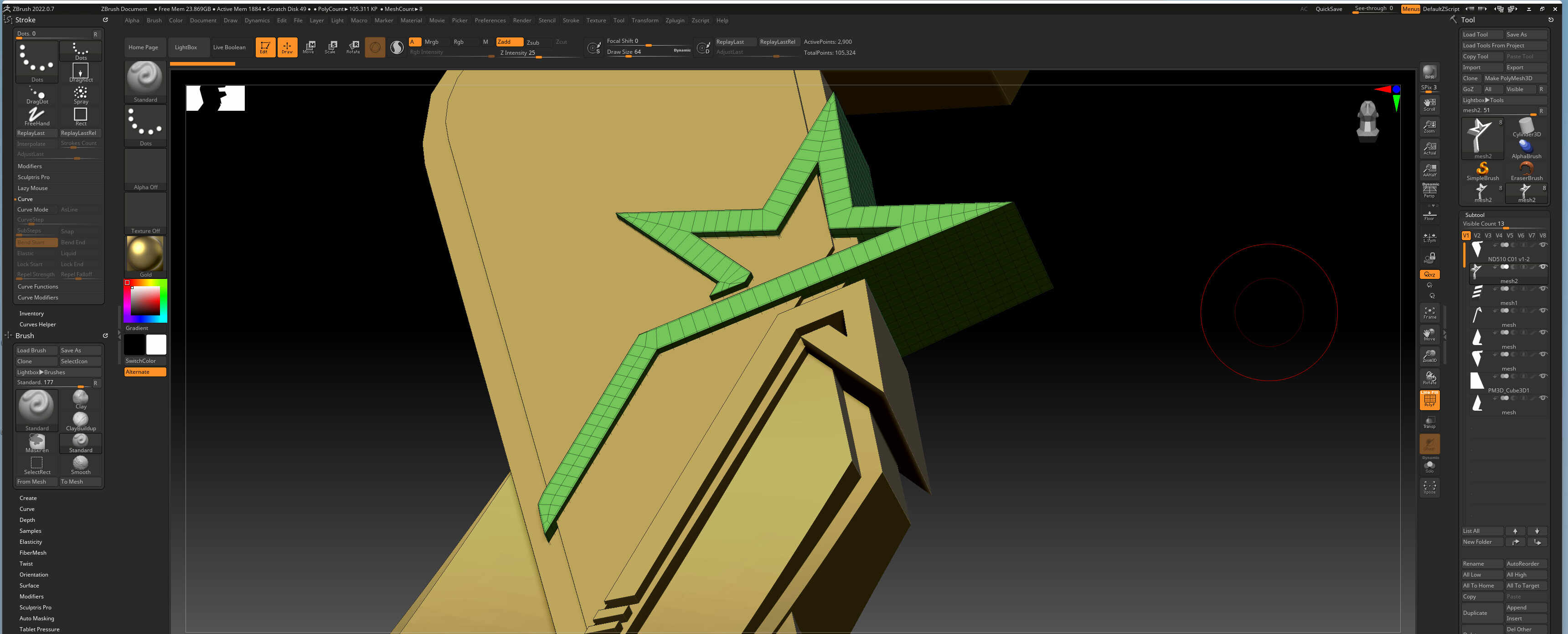

In this example I brough some shapes in from Adobe illustrator using Text 3D / Vetor Shapes imported as an SVG file. I used the ZModeler brush to polygroup front, back and sides. I then creased the hard edges and used ZRemesher with Keep Creases and Detect Edges selected. This resulted in what appears to be a nice clean low poly mesh.
Star Geom

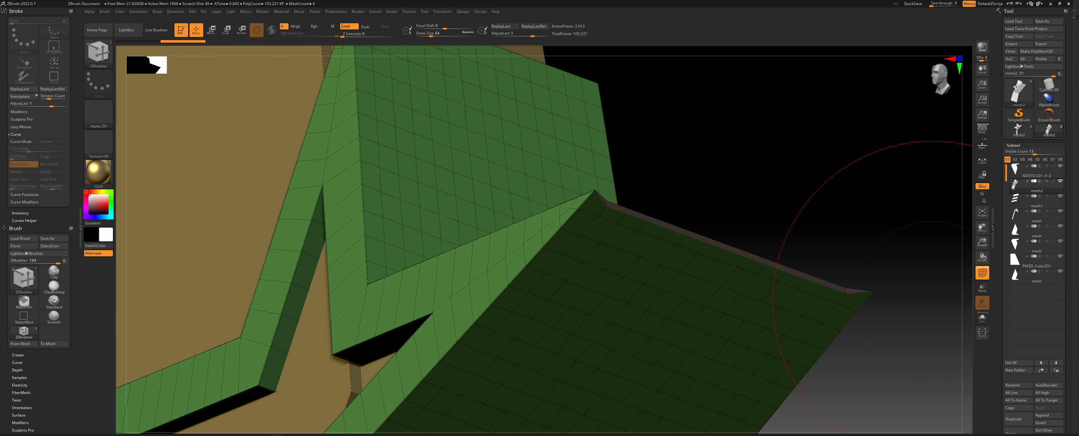

When I try to use the ZModeler>Bevel tool I am getting some uneven results and awkward geometry. I have played around with bridging points to split the corner transitions but there’s something I’m clearly not getting right as I can not achieve a nice even bevel around the star shape perimeter. I have also tried bevel by curve with zero success.

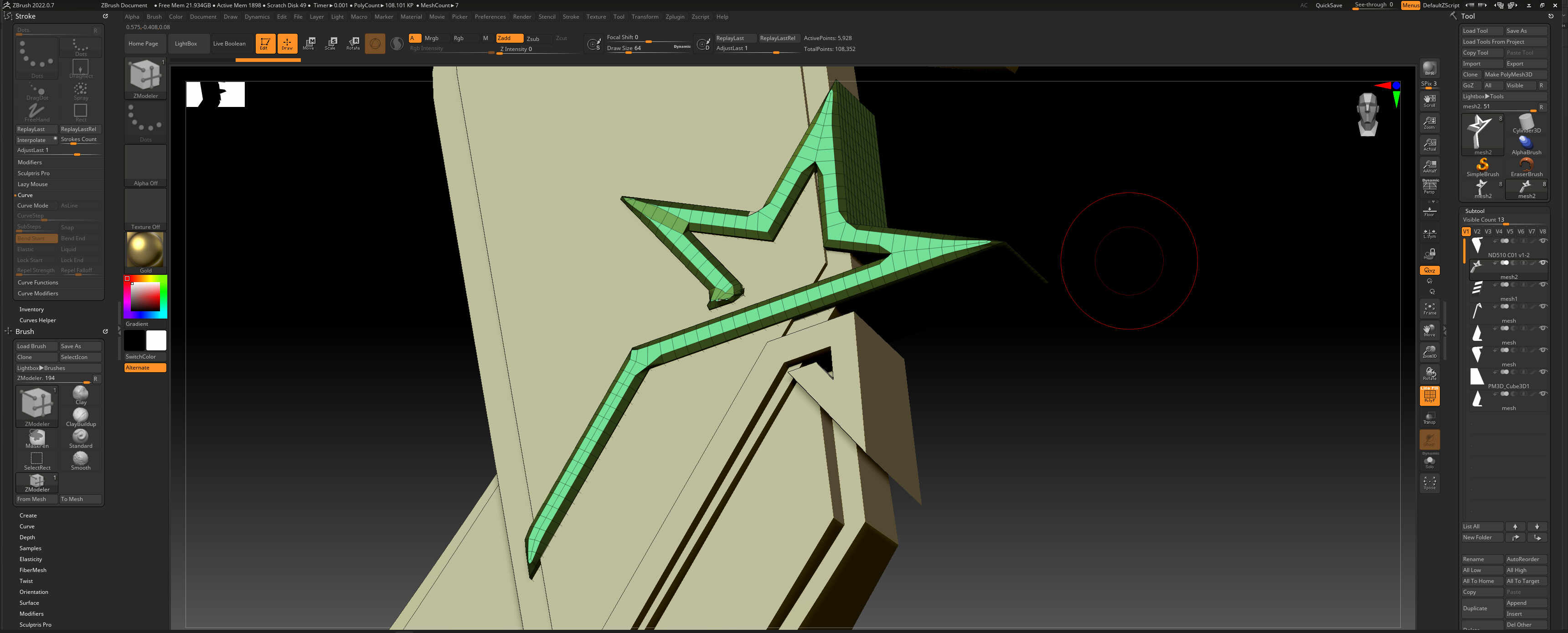

Also I need to round off the star points as I intend to make this item in polyresin eventually. The sharp points of the star would be fragile and feel unpleasant to hold. When I try to bevel the edges it is leaving the front points unaffected and pointy…
Star Geom Bev Star Tips

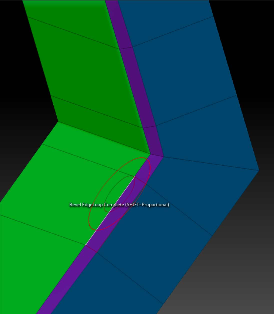

Please see the following example in some star shaped geometry I have quickly modeled to match some of the things I see going on in yours. The long sides of your star shape have nice clean unbroken edge loops running its entire length. ZModeler will be able to easily identify these and bevel them in a single operation. Note that the edge loop in question is made up entirely by quad polygons and the points all have exactly 4 “spokes” or edges converging in the point. This is an ideal low poly bevel scenario.

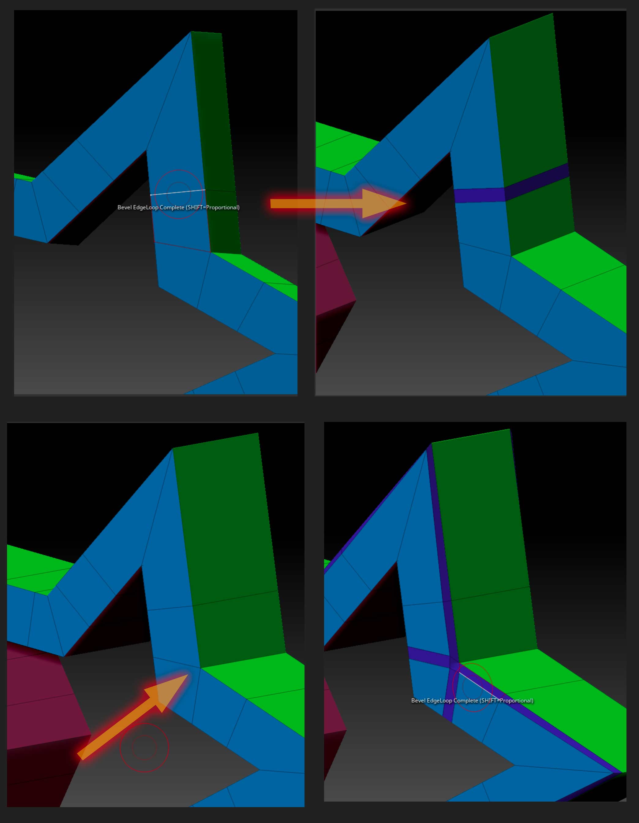

However the inside corners have a different configuration with two edges converging in a triangular join, and the point there has five spokes instead of four. This type of topology may disrupt ZModeler’s ability to find an edge loop, and will change the way that the points in the Bevel operation slide along those edges. There may be contextual differences in the results you get depending on which edge you click on and at which angle. However most attempts to bevel that geometry all at once are going to find that ZModeler is unable to find the loop there, and that the bevel created in that location differs because of the way the edges converge. You also have a similar issue at the tips of your star points because of the divergent geometry there.
lowpoly
Poles and triangular geometry will often complicate topology to the point that Zmodeler can no longer find the edge loops when these are involved in the path. When working with low poly modeling you are entirely bound by the topology of your subject. You will need to redraw the topology in such a way that it supports the operation you are attempting, or you will need to try a different approach. There are usually many different ways to do the same thing.
Please see in the following example that redrawing the topology on that corner so that there is only a single edge at the corner and no triangular joins produces much cleaner results:
better
So in order to model effectively at low poly you’ll need very deliberate and tightly controlled topology. However the method you chose to create your initial topology was “quick and dirty”. So you would need to either refine your topology for the purpose of modelling, or choose an alternate method that is not as reliant on topology.
