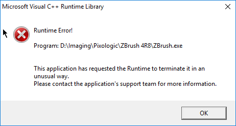

Issue description :
The localization crashes Zbrush at the startup
if i compile my plugin with this uncommented line :
[RoutineCall, InitZFUtilsTests]
i get this :
Now if i run Zbrush, with that line disable, Zbrush will starts correctly,
I edit my plugin code removing the // before that line, then I reload the plugin, and the localization is working great.
It seems like the ZFU_RegisterLocalizationFile is the source of the crash .
Any idea what’s is going wrong ? i make sure i use the very last version of the zfileutil.dll but it doesn’t resolve the issue.

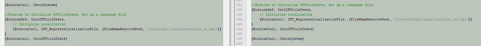

The point about <zscriptinsert> is the code is inserted at that point. Sometimes that can be critical.
Have you tried the test zscript included in the ZFileUtils zip? Does that give the same error? If so, please let me know what OS you are on, so I can look into it. If you don’t get the error then there’s a problem with your code.
great it doesn’t crashes anymore, it’s seems important to implement the routine before the [routinedef, checkSystem,//routine code] and [routinecall, checksystem]

The CheckSystem routine sets the dllPath variable with the path to the DLL file. That needs to be set first so that all calls to the DLL using [FileExecute] can find the DLL and run. If you call InitZFUtilsTests first then when that routine calls ZFU_RegisterLocalizationFile it will fail.
yes exactly at some point it worked with the correct order, and after reverting the disabling of some code sections, it doesn’t work anymore :confused:

I can share the header in case you spot anything , i let the checksystem after the initzfileutils

//Routine to Initialize ZFUtilsTests, set up a language file
[RoutineDef, InitZFUtilsTests,// Initialize localization
[RoutineCall, ZFU_RegisterLocalizationFile, [FileNameResolvePath, “zTexturerData/lang/ztexturer_en.xml”]]
[RoutineCall, CheckSystem]
Fixed :slight_smile:
i got to move routines, and ui from one file to a new one, and finally it work this way.
I have no idea what was the source of the bug, it s a complete mystery.
