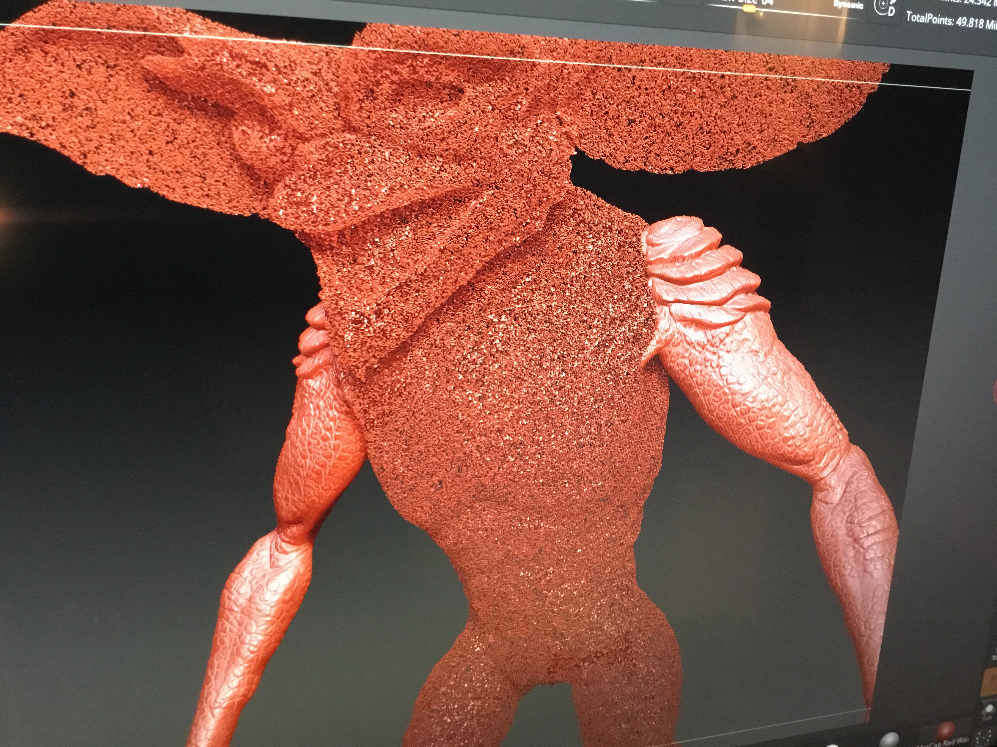

HI, i was hoping to get some help,
I’ve just installed zbrush 2019.1

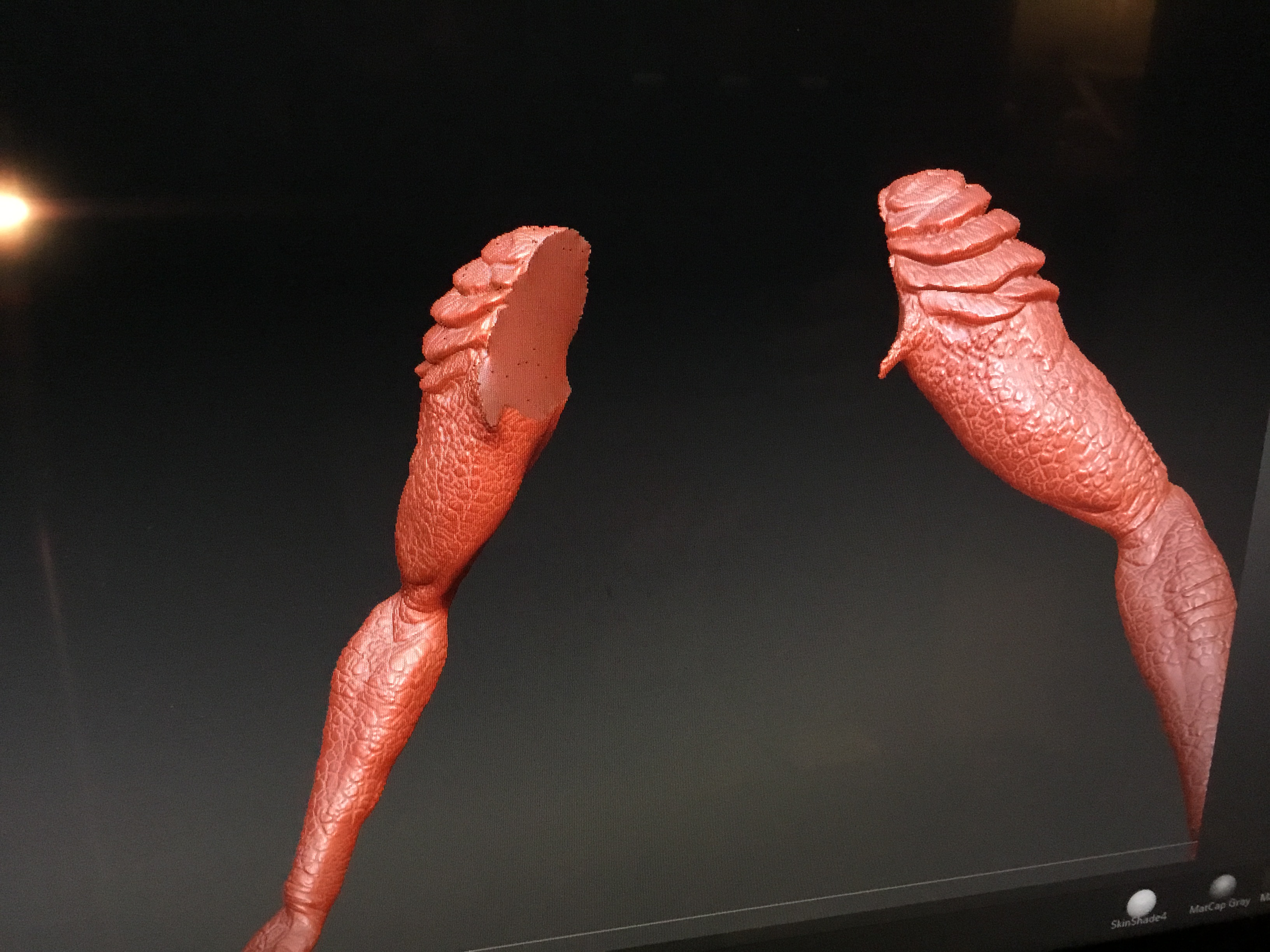

I ‘duplicate’ my master subtool of a character, then seperate the ‘duplicate’ into sections using the looptool > delete hidden > close holes, (to remove the arms, I do not modify the model in anyway, other than this).

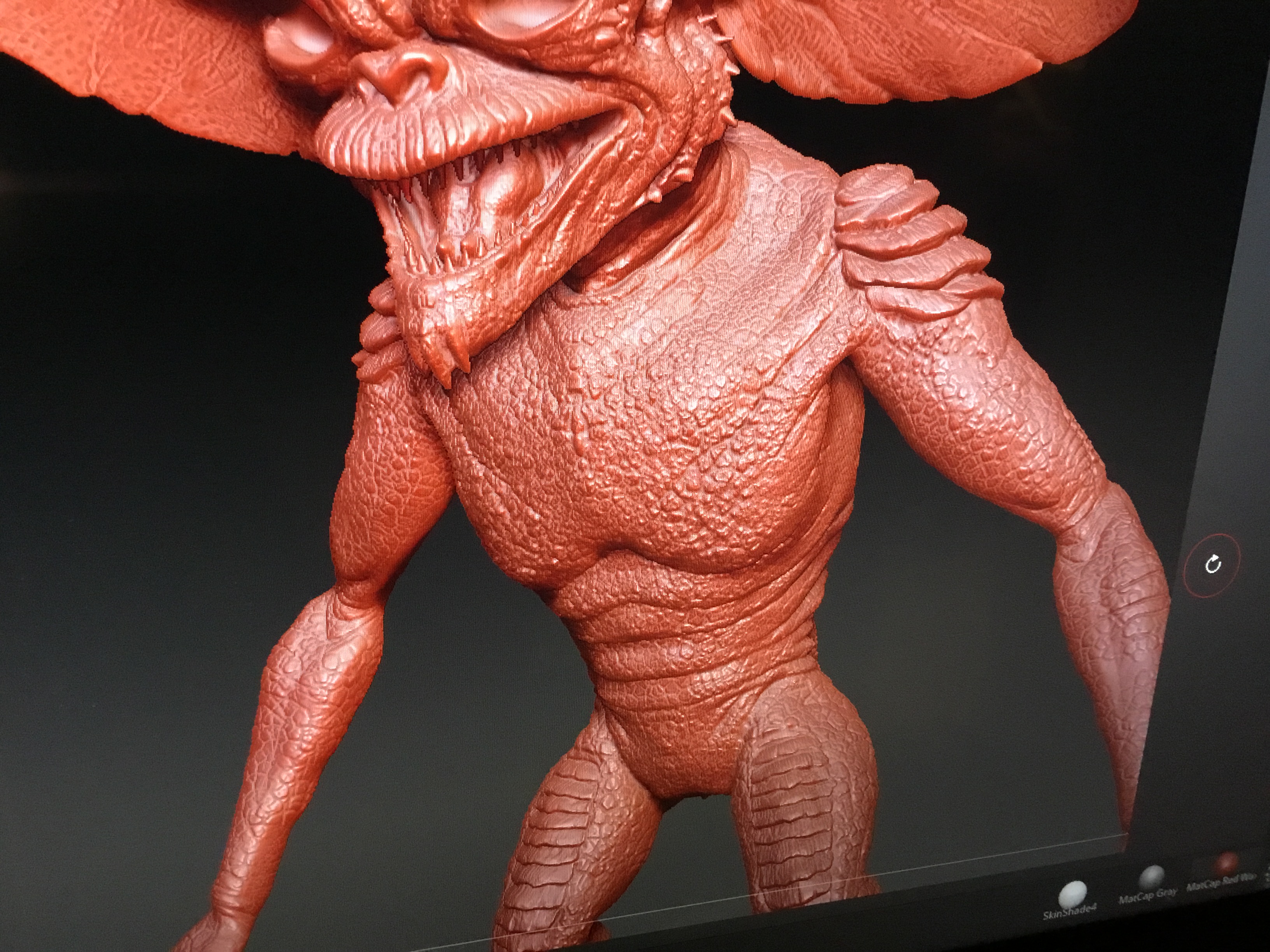

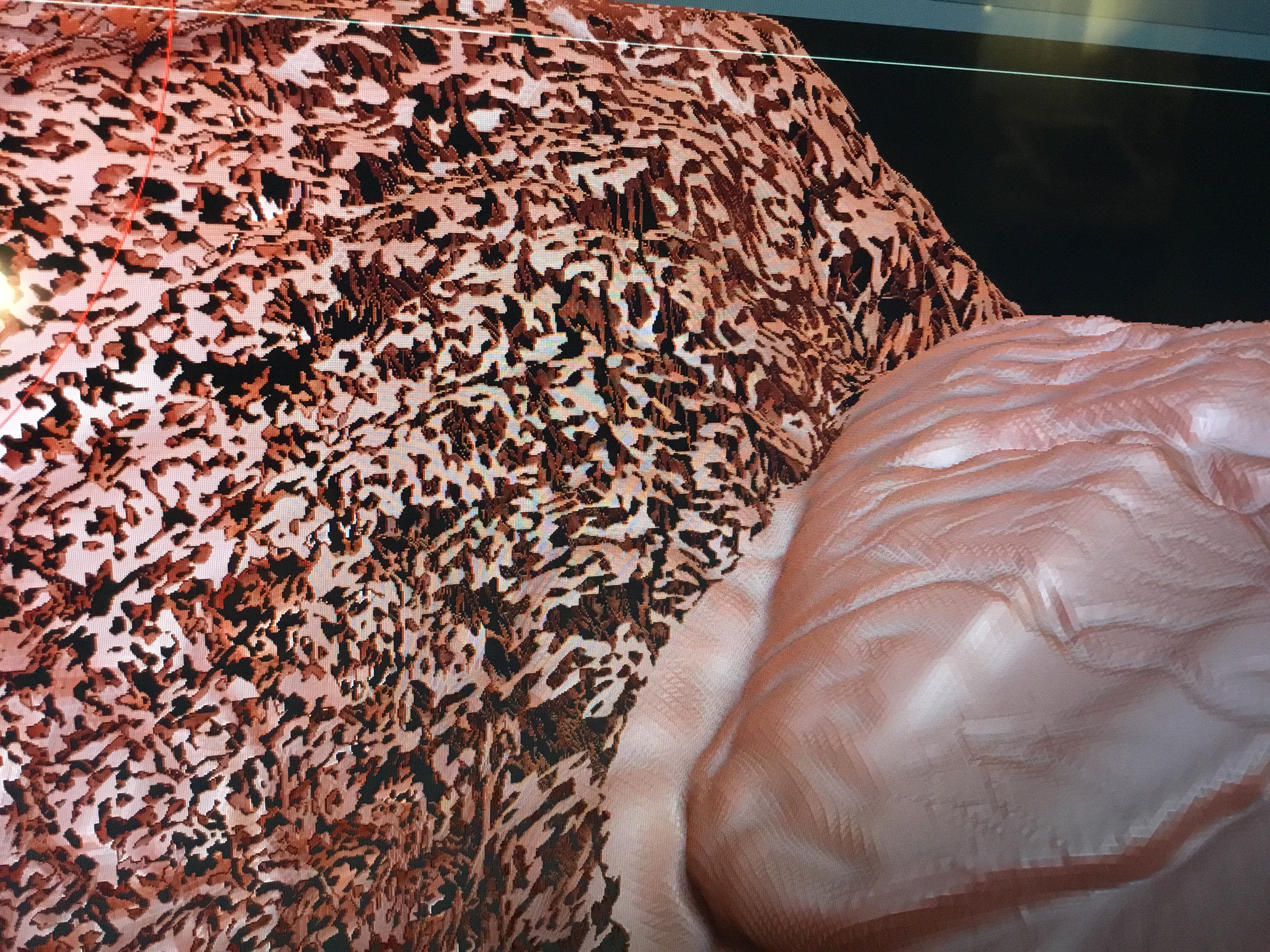

I then complete a ‘live boolean’ operation, the live render shows up absolutly fine and removes the object. I can fully rotate it and everything looks perfectly fine, however when I click I ‘make boolean mesh’ and ‘append’ the item, it comes through with a strange noise/camoflage surface layer that is not there previously?, the models are Identical in every way, its an exact duplicate???
I had previously tried this process/operation on a friends older version of Zbrush 4R8, and from what i remember the boolean process ran absolutly fine and seperated the items without this wierd surface noise. Is this an issue with 2019.1? Or is there a setting that needs adjusting? Or am I missing some thing?
I was wondering if someone could please help me resolve this issue?
Thank you.
image image image image

I could be mistaken here, but it looks to me like maybe you are trying to subtract a portion of a mesh, with a duplicate of that mesh. The potential problem with that is that the subtraction mesh may not completely cover the target mesh. It may occupy mostly the same space, but there may not be enough overlap there to keep ZBrush from getting confused about what should be cut and what should stay.
Make sure any Live Boolean mesh completely envelops the mesh you want to cut away.
