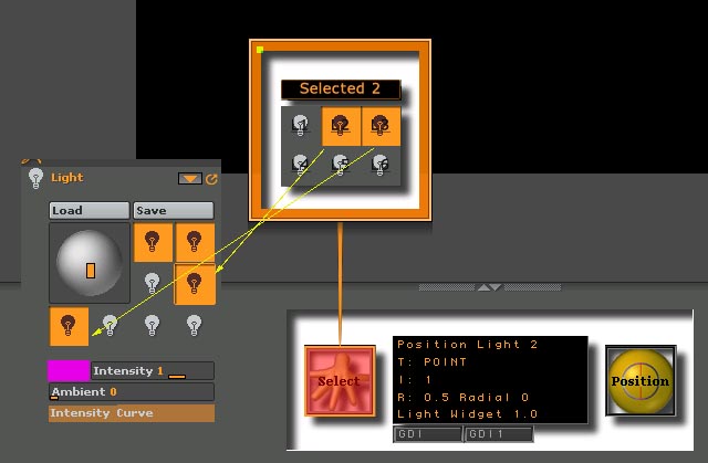

Aye, it is a bit confusing I realize, here is the scoop
Since my script does not work with sun lights and the first two lights in the Light palette are sun type by default the Select Menu only shows the lights following Light 2. (hope that makes sense)
Try this
Note you have to set up your lights in the Light Palette first.
  1. In the light palette select Light #3 and set it to be a point light. Adjust the intensity, color, Radius etc…
  2. In the light Widget press the Select Button. You should see the first Icon selected (First Non-Sun light)
  3. Press the Icon and the script will give you an object which you can place in the scene
  4. Use the Gyro to position the object to a location on the canvas you wish your light to illuminate from.
  5. Press the Position button and the script will automatically set the position sliders in the Light Palette.
If you have set up more lights continue to select each one and position them. Remember you have to set them up first in the Light Palette.
Hope this helps!

Could be that you are trying to use Sun type lights, which the script can’t position. Make sure that they are Glow, Spot or Point type lights. Also I have noticed there is a little confusion about which light in the script controls which light in the Light Palette. I have attached a image showing that the first two lights in the Zbrush Light Palette are ignored as they are normally Sun type lights. The first button in the Script menu is actually Light #3. Hopefully the image will make that clear.
